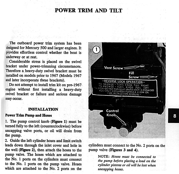

The pump has a reverse lock on it and 4ea lines coming off it
Can someone please identify this pump so I know what I need to order

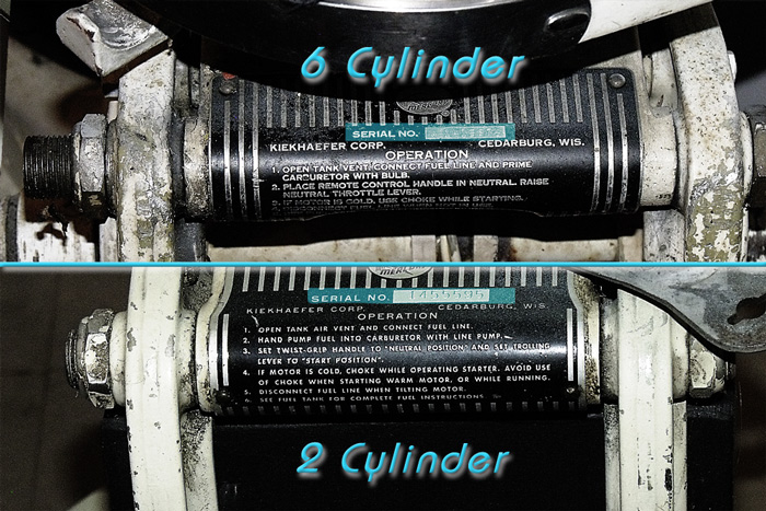

Serial # of the motor ?----Best to do a complete evaluation of this motor first.-----No need to spend money on the replacement pump if it just needs simple repairs.
Hook up the power to the motor and press the buttons to see if it runs, the hoses are available online - you need 4 two small ones and 2 large; there's a knob on the front for the reverse lock.

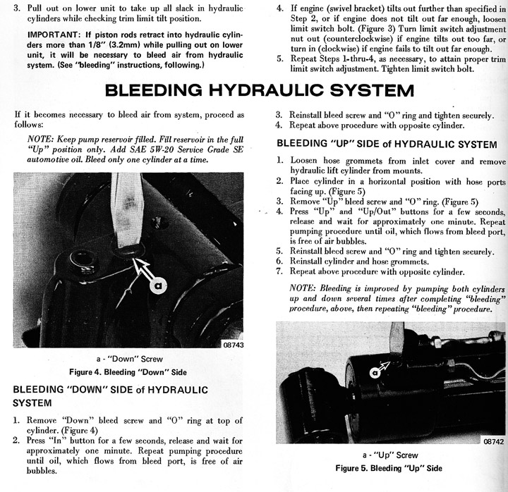

If the motor is OK oil should be pumped out of the lines; replace them and bleed.

Pump call for 20w oil on the side of it, the last person was running power trim/ steering fluid. Talked to a boat shop and they said run any oil in it and you will be fine? Any thoughts on that?
BTW can not find the serial number on the motor anywhere there is a white tag on the front of it that has only this info, the rest of the tag is missing
