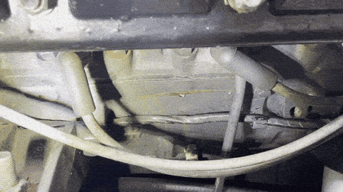

Found a crack in my block. Below head gasket, above passenger brass drain petcock. Link: video

My question is what type of money to save it? And if I spent the money, what should I do? For this work I will not be doing it myself so I will be paying for the entire job. Ive been reading posts here and the general advice is (in no order):

the cheapest (up front) path would be to get a rebuilt long block and swap the bolt-ons...given the age, I'd probably get another intake going this way. Especially if you are happy with the Cobra drive on the boat.
Replacement with the Mercruiser setup will be very expensive and probably cost prohibitive.
Another option would be to get a turnkey engine with a warranty...
its really a matter of personal choice as only you know how much thinner your wallet can go....

Speaking to a local and trusted marine mechanic he said that the 350 blocks are harder and harder to come by. In upstate used 5.7's are going for ~$4k. Full job would be $5-$6k.
They are readily available...given the current fiscal policy, the price won't come down anytime soon...
