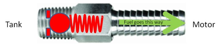

Not seeing any pressure check the antisiphone valve on top the tank. It's a barbed fitting that the rubber fuel line connects to

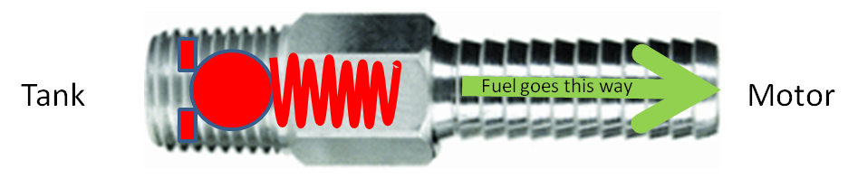

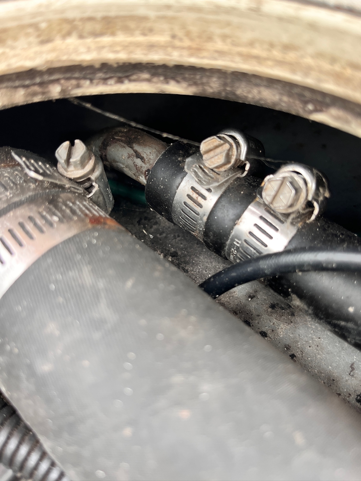

Thanks We ran down to look and see no such thing on the pickup and the hose goes into the abyss that would require surgery. Are they always at the pickup? Would a psycho builder put one in a non accessible area requiring floor surgery to get too? I guess we could test an aux tank to test the theory.
We also ran a bore scope along the pickup line. Best we could chase it was two feet before it turned someplace weird. This tank sends the lines forward (for the fill hose) and then they have todo a ridiculous 180 somewhere to get back to filters.
I understand their importance for safety so would assume they must be right at tank and not downstream such as at the filters...which they are not.
Attached photo of our fill hose and pickup on a 1997 Pursuit Denali 2460
Well it's a USCG requirement unless the filter is above the top of the tank.
Either way ok.
Try this, disconnect fuel line going into the filter and attach a piece of fuel to it and put the other end inside a gas can. See if pressure can be built up this way. If it can then it's in the fuel line or tank
