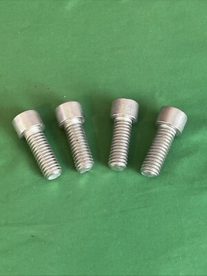

Anyone know the size of Volvo part # 941810? It's a socket cap screw used on a 270 outdrive to fasten the lower gear unit to the intermediate housing. I discovered one was missing and another one very loose. Does anyone have an extra? Thanks!
Thank you Capt Bob! I just ordered them. Do you think that having a missing one of those screws and one real loose between the lower gear unit and the intermediate housing would have caused oil to get into the exhaust bellows? I ask because I found oil in the area of the small drain hole in the exhaust bellows....no other tears or rips in the bellows, so am thinking the oild was dripping from there. The oil level in the outdrive was also about 1/8 quart (give or take) so I assume the oil I found was outdrive oil.
