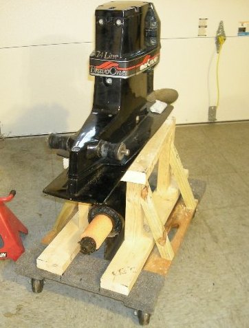

Decided removing and storing drive in garage for winter is best solution for me.
Built this stand in about an hour, measured to fit so that I pull prop off, slide stand in, trim drive down, unbolt her and she slides right off the back of the boat. Zero lifting......................... What a back saver this was.... Total cost was
almost zip, except for 2 2x4's and a piece of 1x1 and the dolly I had lying around, but that cost less than 20 at the H Depot store a few years ago.
