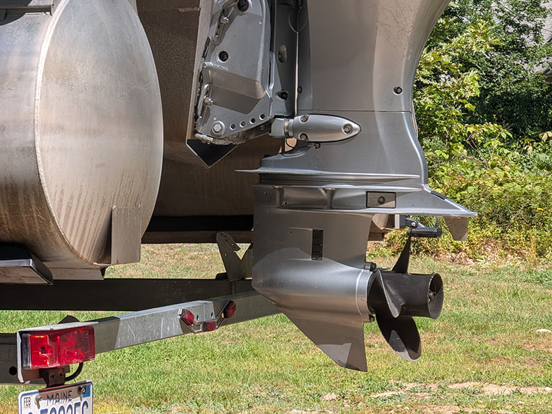

So that's the back story, the issue I can't resolve is described below, also it's on a 20' pontoon

*Someone suggested lowering the engine because someone shared a video with a very similar Evinrude(?) overheat issue what was solved by lowering the engine? Lowering engine also a pain as I will have to cut the bolts, they are cheap stainless trash, tried turning one of them and tit immediately stripped, had to cut it off and replace it. Also I have no way of supporting this engine, would have to bring it somewhere with a hoist just to drop it one hole (that's all the room I have)

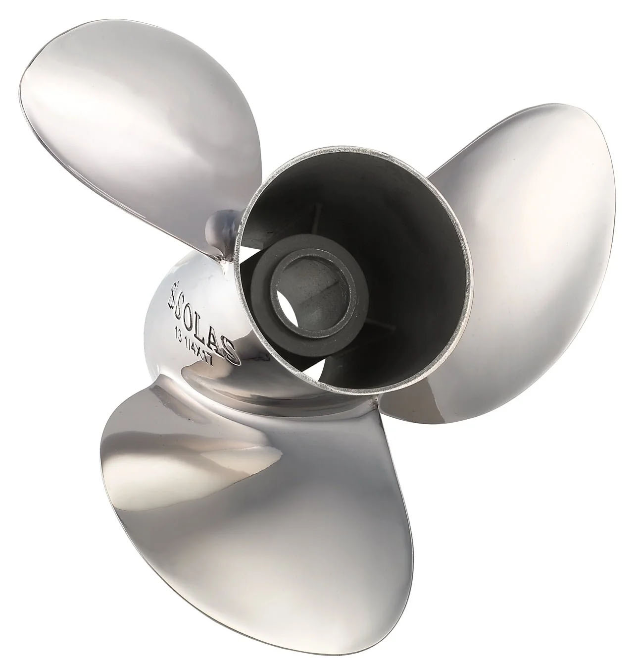

Also tried different prop, went from 15p to 17P and it would not get past 5,000, but I could run WOT all day long with 17P prop
I don’t know about engine height on a pontoon but I’ve used only a floor jack to move an outboard up or down. Loosen all bolts with the jack taking the load, block the wheels on the jack if on asphalt or concrete. Use a big screwdriver in the top bolt holes to align them in the new location. I use a block of wood on the jack. Works on my whaler and 500lb 130.

For lowering or raising the engine I have read where a guy used the front jack on the trailer and a couple of helpers to support the engine. Extend the jack to maximum height, wood under the skeg then lower the jack which will bring the transom up till the hole align. The trailer axle acts as the pivot point. I’ve never tried it but it sounded like a slick idea…no hoist required.
I'll drop the motor this weekend, got better bolts from McMaster, hopefully those don't need to be cut off every time.
Water pump is easy enough as well so I'll get that done over the weekend
