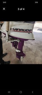

Hello All,
New to the site but looking fwd to getting smarter with your help. I am setting up a little 14 ft wooden skiff and found a nice $200 engine through a friend. 18 HP and my biggest concern is what to do, prior to attempting to start. My intentions are, w/p impeller, lower unit oil, plugs, ???. Should I prelube the cylinders prior to spinning it over? It also has a few wiring issues, but I think I can resolve them. I know it's an odd color, Purple and I couldn't find that option anywhere?? Lol...! Thanks in advance!

A little fogging oil in the spark plug holes and through the carb throat, then turning the engine by hand with the plugs removed is always a decent idea on an engine that has sat for a long time.
Thank you Kevin! I just didn't know where to start. I believe this is a 1969 Fastwin, and the gentleman said it had been layed up for at least 25v years. It shows very little use. Paint on the prop, power head, externally, etc... So I didn't want to create problems by getting it back to running. Have you ever seen a Purple one? I'm just curious as I wondered if it was some kind've of promotion. I looked at all the paint codes, and did not see that color option. It has a few wires which are not connected but I'm trying to figure those out. Again, thanks my friend!

Fogging oil is always a good idea. Tilt the motor up, and spray it while the piston is down to help get better coverage.
Like Kevin said above, down the carb also to get some lube on the bearings.
Probably smoke like mad when it starts but at least it will be lubricated.

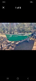

Yes sir! I am hoping it comes back around. Looks too be a solid little engine and I've read good things about it. So we'll see here soon. I bought a 14 ft wooden skiff and I'm hoping this lil 18 will push it. Thank you, again

Electric start 18. Nice! Love the paint scheme. She should run in the low 20's on that skiff. She's a 1969, assuming she is original. Just hook up a 50/1 fuel mix, a pint to six gallons.TCW-3 oil, put her deep in a trash can or the lake, pull out the choke, turn the handle to start in neutral, and if she doesn't start in 7 pulls, start asking questions on this site. main thing if it starts, is she pumping water? Nothing bad will happen in 5 minutes of running.

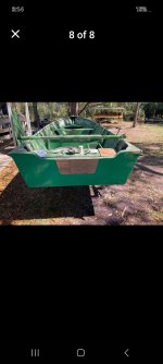

Thank you sir!! When I saw this lil engine, I couldn't pass it up for $200. It shows now wear. The owner said it was his friends father's and it had been in their shop for the last 25+ years. It was covered in saw dust. Lol... Anyway thank you and I'll try and have it running here in the next few weeks. Looking fwd to seeing it hanging off of the back of that lil skiff. I really appreciate all the help from this y'all. You guys are awesome! Please excuse my excitement, but with this being my latest project, I'm over the top. I met the granddaughter of the man who built the boat, and she said he was, "an avid fisherman, sportsman, quail hunter, and wildlife photographer". He is Mr. William Sanchez (DDS) of St. Augustine FL. To pair it with this ole Evinrude Purple power pack, has got me excited. I can't thank you guys enough for helping me...! I really mean that!! Cheers to you all!! You guys are the best group of folks, I've ever met!

This lil old skiff was built in 1957. The Dr. even built the trailer. I'm hoping this 69' Fastwin will put her back in action. Looking fwd to stretching her legs, again! Cheers to you all!
