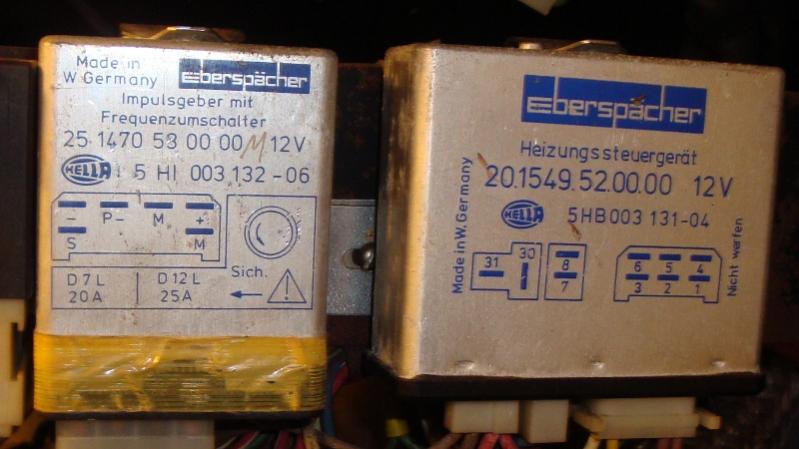

It's a D5LC 12 V (25 1861 01) from 1998 with a 7 day timer/modulator (401 00 191) with (indoor) temp sensor, (no diagnostic).

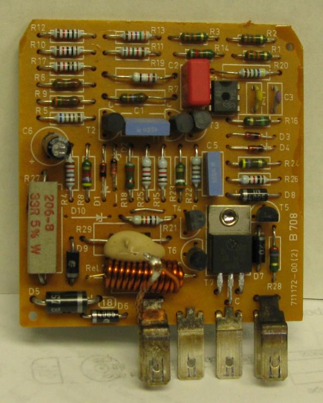

Glow plug has 0.6 Ohm measured from the Current regulator plug, bench tested with 13,2 V in and 12.08V out, without load.
All conectors free from corosion
Flame sensor 1016 Ohm at control unit, Safety thermal switch Ok
The two resistors on PCB 12 ohm and 1,5 ohm is checked Ok
Control unit, Current regulator, PCB checked for corosion Ok.
