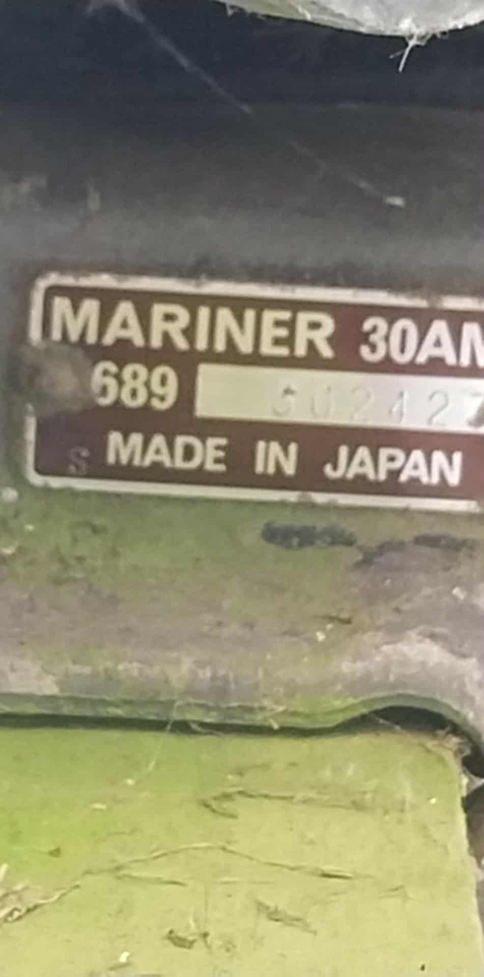

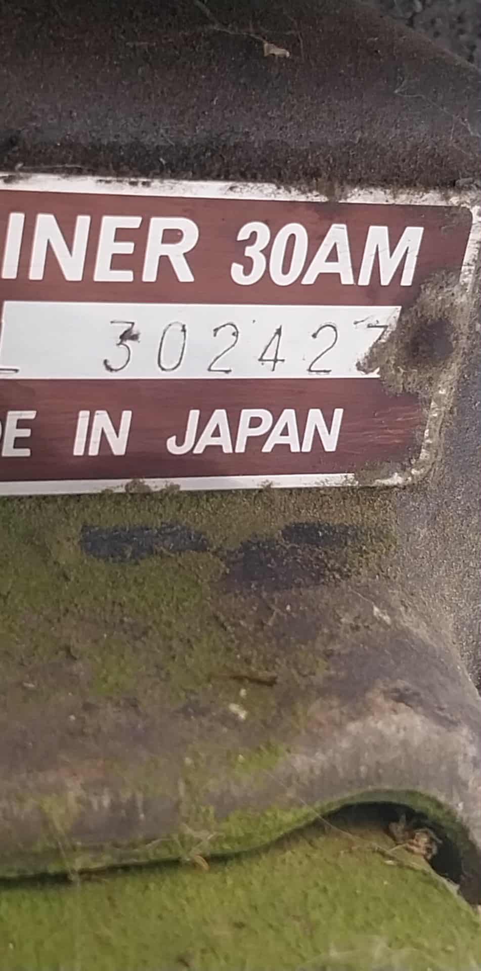

If someone could help it would be greatly appreciated I also have a 30AE with the badge that reads 689-S-101350 and have no luck in finding any parts or any information on the motor
Similar to a Yamaha USA 30ESN/ELN. Check out the Yamaha parts catalogs for either model, available from a number of US dealers.
