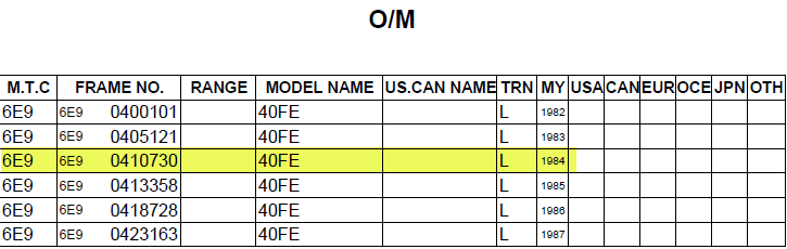

From where does marinengine.com get their data? Reason why I ask is because Yamaha documentation indicates 6E9L 411198 to be a 1984 model year motor.In searching your serial number ‘Your model number is 7040522 making the engine to be a 1982 Outboard 40 [EL]. (L=Long Shaft)...Search the model number online too, https://www.marineengine.com/parts/...s/40c-twin-carb/6e9400231-thru-6e9423162---el
6E9L 411198 is the Yamaha Primary Identification. AKA the PID. Not the model of the motor.I am Lost . I have a Mariner 40 . This is every thing on the Tag 40E 6E9 L 411198 . When I put that in for parts It can't find it . Am I doing some thing wrong . What am I missing . Can some one help ......
I believe it should be that both Marine Engine and crowleymarine and others pull the info from Mercury marine databases of the engines they have sold and use for parts look up. There is a trick at making the serial numbers work for these styles of serial number ranges (6E9, etc.) for a computer search look up.From where does marinengine.com get their data? Reason why I ask is because Yamaha documentation indicates 6E9L 411198 to be a 1984 model year motor.
6E9 being the Yamaha prefix code. L indicating the shaft length. 411198 being the Yamaha serial number.

Over the years of helping find year models like this I never really used a chart from Yamaha (though I've seen it) I had just always went to a chart under Mariner in-which gives the 6E9 serial number to year range too before discovering the computer trick and again is either close to the Mariner chart or right on...Sometimes I'll check either just 1 of them, both or more depending on time allowed, etc.. This case was just one check.
So this mentioned, in checking the chart I tend to use suggests this engine to be a 1983 year model putting it in between your 1984 find and mine of 1982...6E9 L 411198
40C EL 6E9-407936 - 6E9-411859 1983
Or the potential 1982 model depending on how one reads the chart...And "might" be how the computer search is generated to suggest 1982.
40 EL 6E9-402516 - 1982
