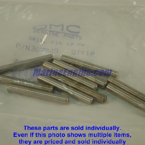

No ned mod number or year, all the same:
DRIVE PIN 0307949
List Price
$1.05
Part Number
0307949 Johnson
0307949 Evinrude
307949 Johnson
307949 Evinrude
Your Price
$1.05
Manufacturer
Evinrude Johnson OMC
And the best part, you may order them from this site!!!;););)

I belive the 307949 are stainless so should do the same job
sounds good have you got a photo. I am not really sure where the rubber goes maybe i can get a replacement rubber. what is the rubber there for? .
