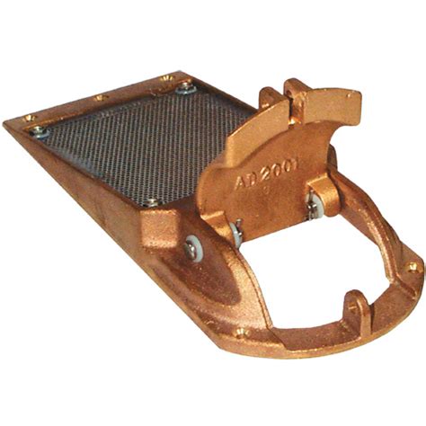

As for the thru-hull seawater pickup, the AQ series drives do not rely on seawater for transmission (upper gear unit) cooling.
You can go with a thru-hull if you want to.
The only downside is surface water debris, whereas with the stern drive seawater intake, it is well below the water line.

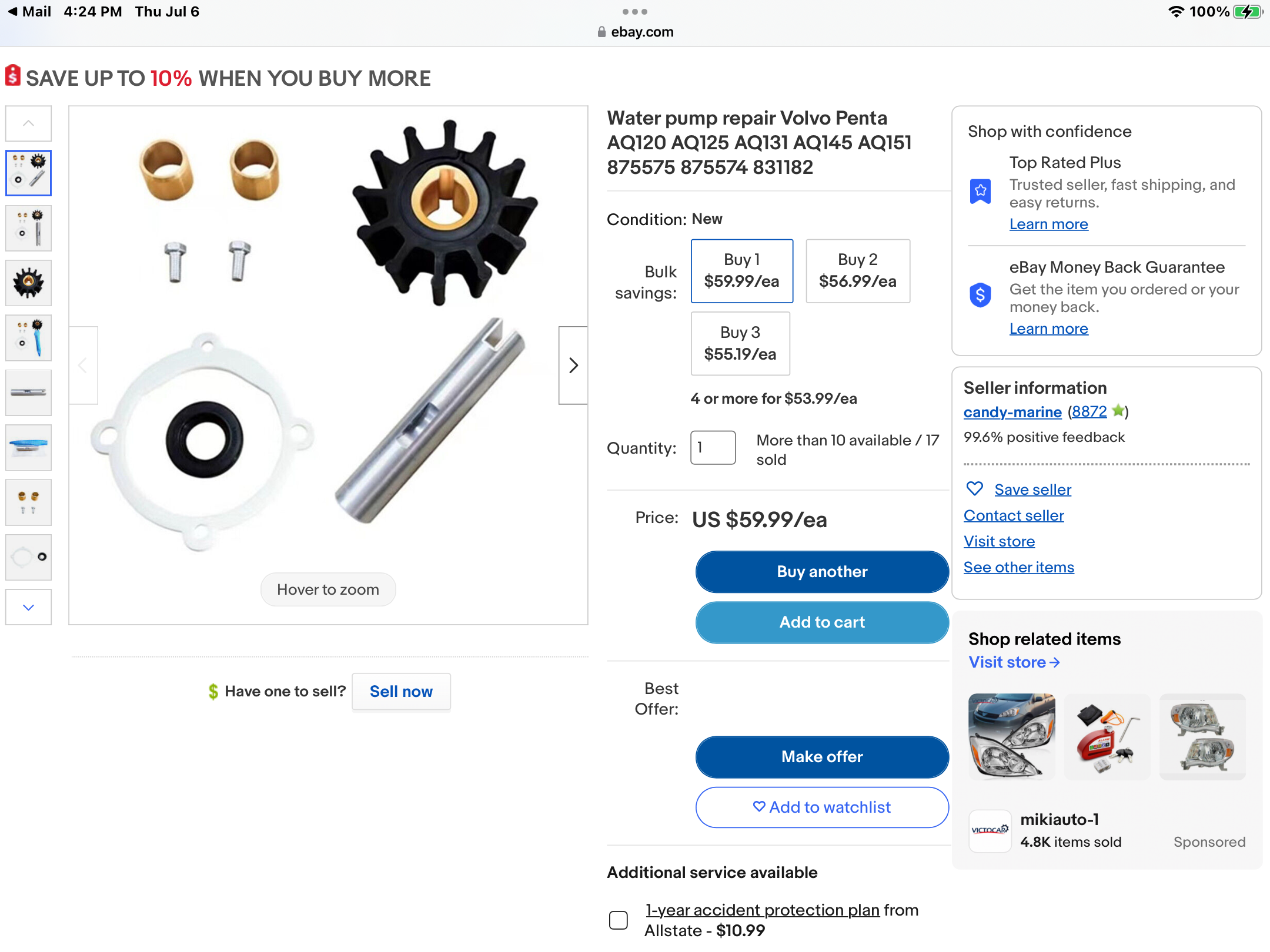

We replaced impeller and it came with a new gasket and key…
Your Volvo Penta OEM pump impeller drive shaft is splined...... no key required.
Sherwood pumps require a key.
