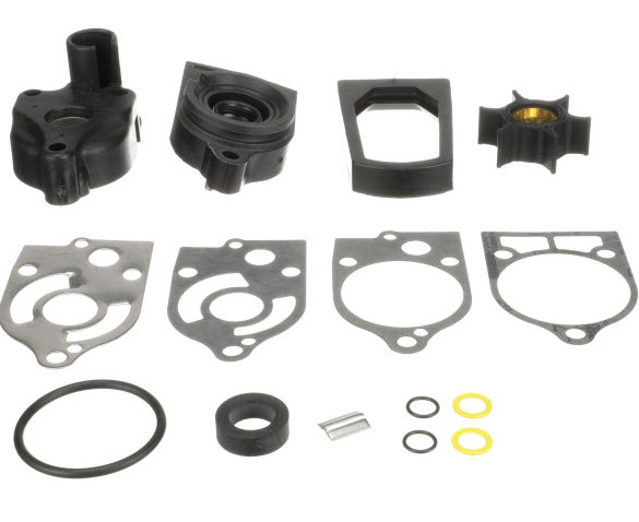

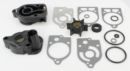

Hello, I'm new to the forum and new to boating. I have a Bayliner Capri with a 50 hp outboard Mercury. It is not pumping water and I've tried clearing the drain. I understand how to pull off the bottom end and replace the impeller. That's what I thought I would do next. The problem is the only numbers I can find on the engine is a tag that says: serial number 6308653. I don't know the correct impeller to order based on this ? I would appreciate any help.

Ok, I feel silly ! I found it recessed in a hole. Got it apart and there is nothing left of the impeller! Up against the impeller housing there was a rubber o ring and a round spring just laying on it. Going to order replacement parts. I hope they come with instructions!
