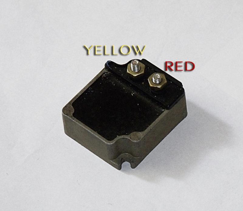

I had to remove one of the magnets from my flywheel. Would that cause my RPM gauge not to work?The gauge is measuring how many times per minute that magnets on the flywheel pass the poles (windings) on the stator.
As the magnets on the flywheel pass the stator (bobbins) that feed the rectifier (which converts the AC produced by the stator to DC to charge your battery) you can think of the transition from one bobbin to the other as a "click" (best way I can think to explain it).
The signal wire that feeds the tach is connected to one of the posts on the rectifier. Those "clicks" are transmitted to the gauge. The gauge counts them. So if there is eight (poles) there will be 8 clicks for each full rotation of the flywheel (1 revolution). So for every 8 clicks the gauge (counts) "per minute" the gauge displays it as a RPM. (That is a rather simplistic explanation which while not exact should give you an idea of what is happening).
So your tach is really just a "counter" - counts clicks per minute, divides them by your pole setting on the gauge and displays them via the needle. No special sensors etc on this type of ignition.
