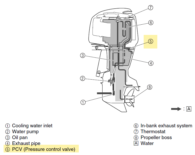

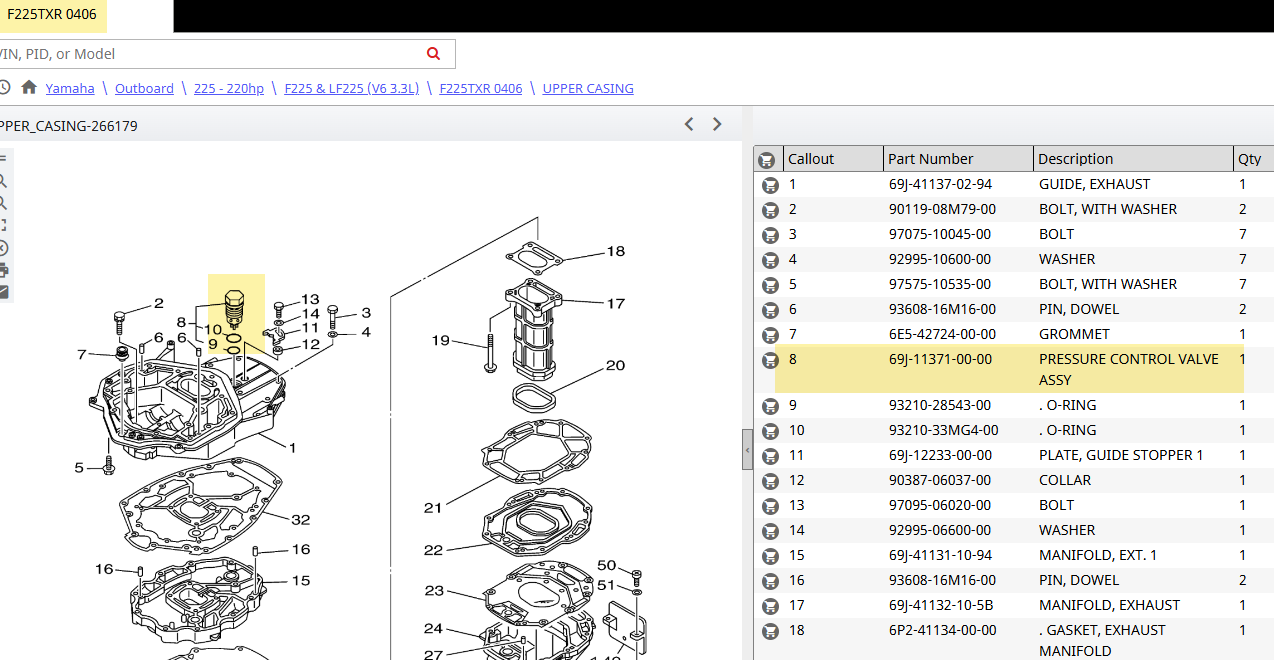

Yamaha refers to the valve as a pressure control valve. Purpose is to open and prevent water pressure from becoming too high when the motor is running at high RPM's. It does not act as some Mercury valves do.
It is located on the exhaust guide. Rear of the motor. A panel has to be removed to gain access.
Nice comprehensive response. That should make the poster's job very easy especially with the diagrams!
