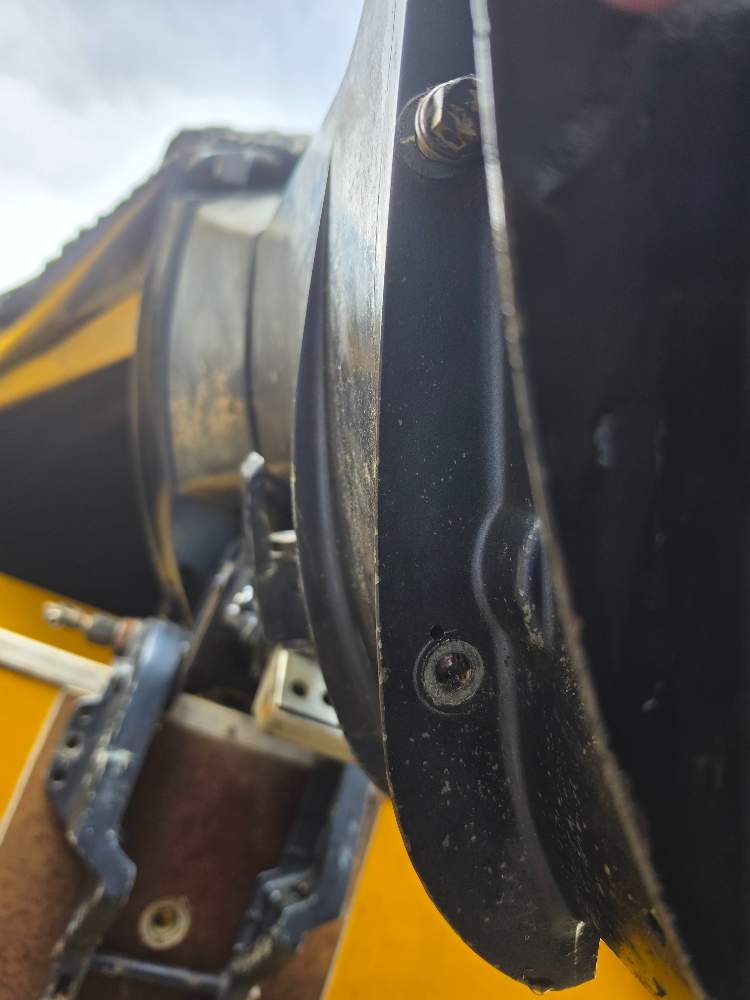

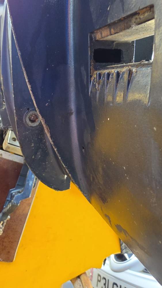

Hey all, hoping for some advice.
I was gifted a Concorde Chevalier by a friend.
Removing the lower unit from the yamaha 30hp and one of the four side bolts sheared leaving threads in top and bottom.
Initial thought was left hand drills and easy outs however, I don't seem to be able to get in due to the fin below.
There must only be 4 or 5 threads left in the lower unit!
Any suggestions on removal genuinely appreciated.
Many thanks
Mike
Image to support issue.
Any hidden bolt under the trim tab ?----The lower unit should now come off with that broken bolt not being an issue.-----Unless the driveshaft is stuck in the crankshaft.

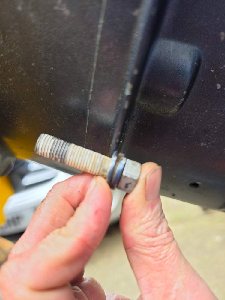

Thanks for the reply :) That's what I hoped. The trim tab bolt sheered as well however, managed to drill that out. Looking at the bolt the threads seem to run into the lower unit, do they not? Thx
No the lower unit is NOT threaded.----The unit should slide off !----=Should have kept the drills in your tool box.
There is salt packed between the bolt and the housing. You will need to heat the housing around the bolt to expand the aluminum to release the salt grip. Use propane or MAPP gas torch to get the job done. Heat in circles around the stuck bolt. Do not directly heat the bolt stub. The goal is to expand the aluminum housing away from the bolt. Be patient and avoid beating on the housing or you'll break the cavitation plate. If it starts to move use wooden door shims and drive them with a hammer to help separate the housing and slide it off of the bolt. Things get hot so wear some BBQ gloves. This is standard practice down here in Florida for salt motors.
Thank you for the advice, very much appreciated. Will give it a go.

Hi, yes disconnected the shift shaft (after a bit of a fight). So far I have had zero movement which is what led me to believe there may be threads in the lower unit and the sheared bolt holding it. Now confirmed that's not the case, seems its a case of heat and patience.

WIN! Managed to get her off today with 1.5 canisters of propane. Only odd couple of small paint chips so chuffed. Thank you for the help and advice!
You're welcome, now you need to deal with the broken bolt, did you manage to get it out? More heat and vice grips to unscrew it out of housing.
