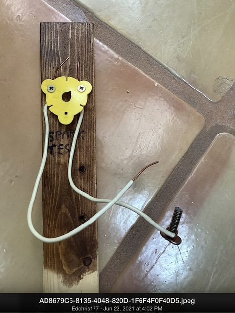

Make a spark tester out of a few scraps, like this. You can use any method to hold the wires, hot glue gun, a short bit of wood or metal with a screw through it etc.

Otherwise i dont really understand the contraption in the pic from you Edchris. heh :oops:
That video is way to much work, might as well spend $10 & buy one. I thought my photo would be self explanatory…
Stick the end with the bolt into your sparkplug boot- the bolt is only there to hold the wire inside the boot, you could also just bend the copper wire into an appropriate sized loop.
Put the other wire to ground-I generally hook it into the sparkplug hole.
Adjust the two short wires to a suitable gap.
Pull starter cord- if a bright blue spark jumps the gap, your spark is good.
