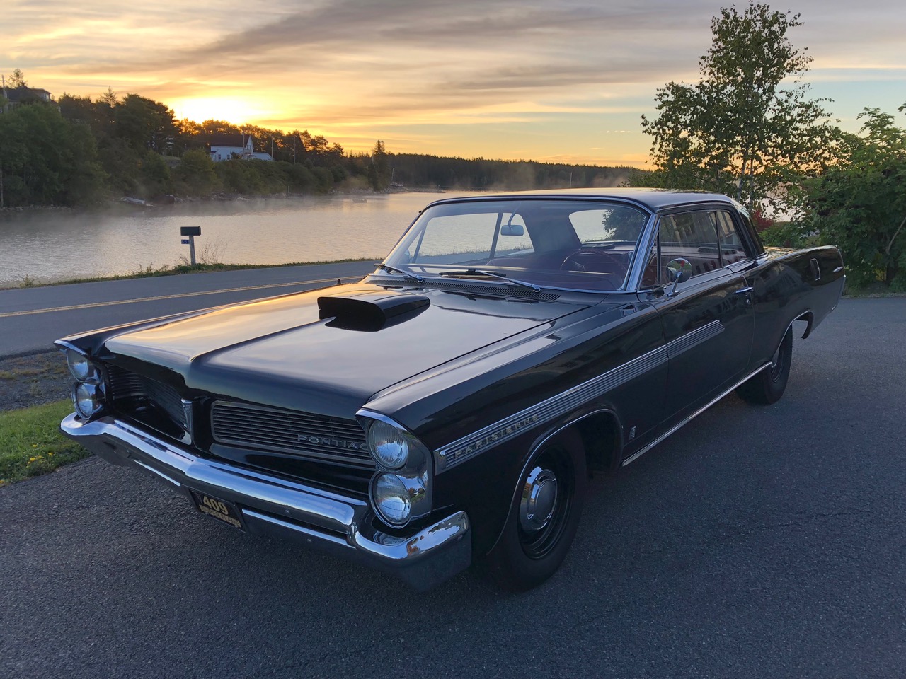

I just this spring replaced the battery in my 1963 Pontiac, it was 21 years old. I’ve never used a battery tender, just kept the cells full and charged them up in the fall.
THAT is FLIPPIN' amazing! I have NEVER had a battery last anywhere near that long!
And, with all the pounding that a boat hull endures at speed, it's even more astonishing a battery would hold up that long....let alone two!
But your Pontiac battery must be some kind of Guinness record!
SWEET RIDE!
Reminds me alot of my college buddies Catalina we used to cruise around in.
Solid and comfy....and fast....piece of HEAVY METAL.
Never seen a two door OR a hood scoop on one of those though!
Does it have a 409 in it?
Hood scoop was not uncommon but not factory, it is a 409 4 speed, the 409 was only available in Canadian Pontiacs.
