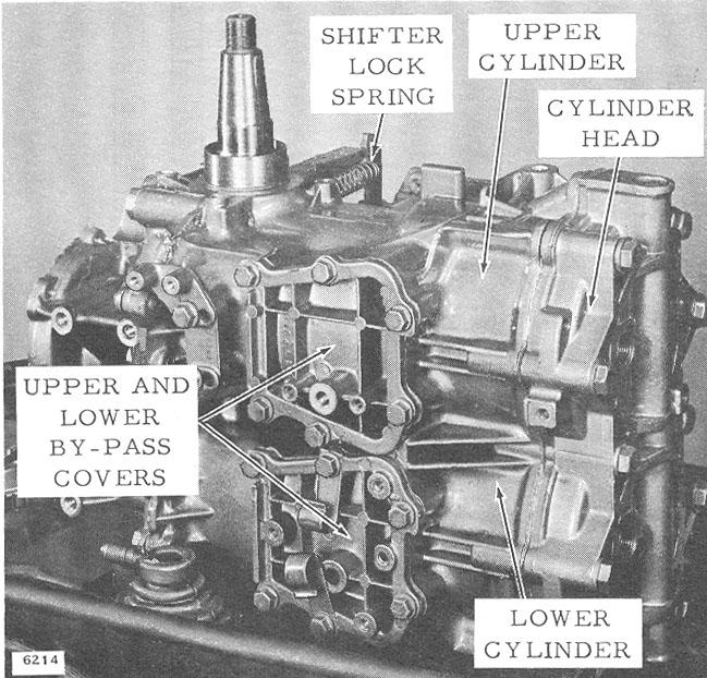

Another observation I had. The by pass covers on this one appear to be ready for a fuel pump, even though this is a 1957 and set up with a two line pressure system. Is it just a drill through the center of one of the covers to modify and make it ready for fuel pump? Would it be best to locate it on top or bottom cylinder?

If the bypass has the 3-hole pattern, a fuel pump will mount directly to it. Only one hole, yes drill and tap for a hose fitting. It really doesn't matter, top or lower cyl.
