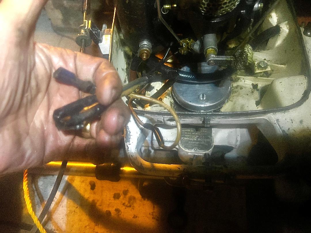

This is my 1959 Johnson Super Seahorse engine I bought recently. It runs fine as is I am trying to identify what these three wires are coming out of the front. The 1966 runabout boat that goes with it has no gages installed. Could that be it? I did order a manual that is not here yet.

Can't make out exactly what wires you are holding. Probably generator wires for use when a generator kit is installed. If no generator, the wires won't be connected to anything. Unless somebody has connected them for some untended use.
As said, generator wires come in from side plug, and won't be connected to anything if no generator kit is installed. They are yellow and blue wires. But people often would appropriate for some other use.
