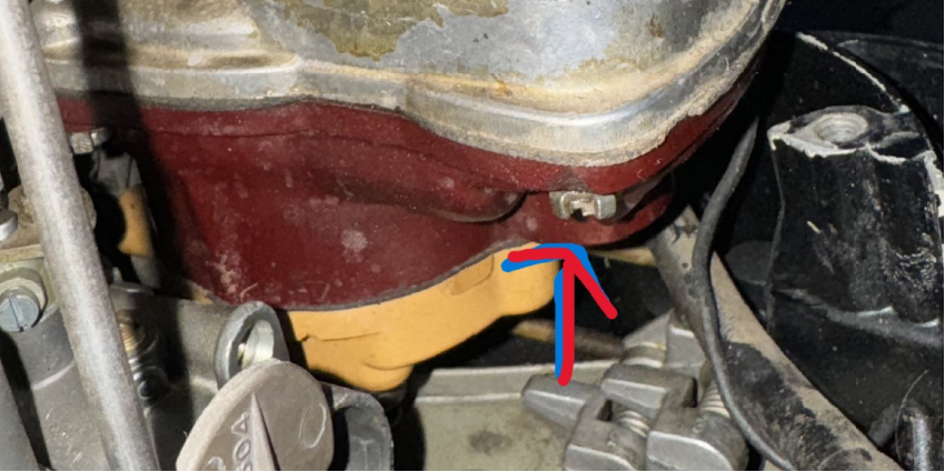

Simple.----There are 4 screws that allow you to remove bottom part of magneto.----And before you ask there is no need to worry about timing when you do that.

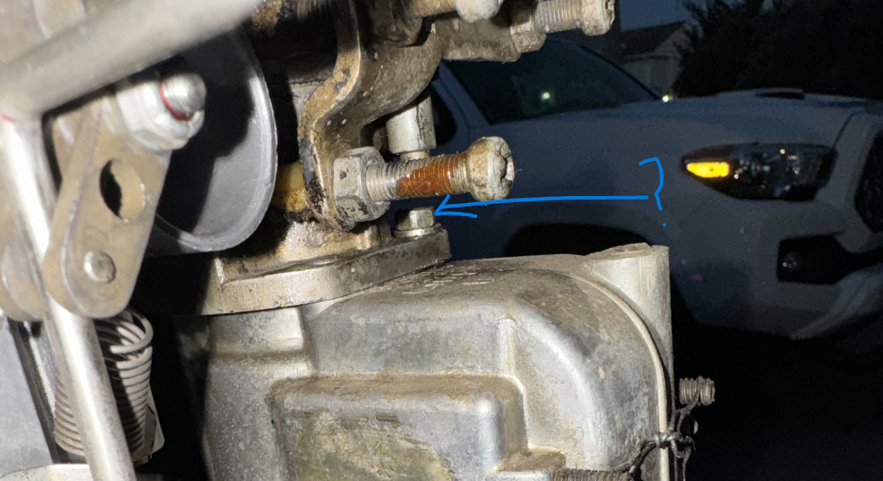

are you talking about these screws?
Because they are seemingly impossible to get at all of them...should I need to remove the carbs? or am i missing something simple?

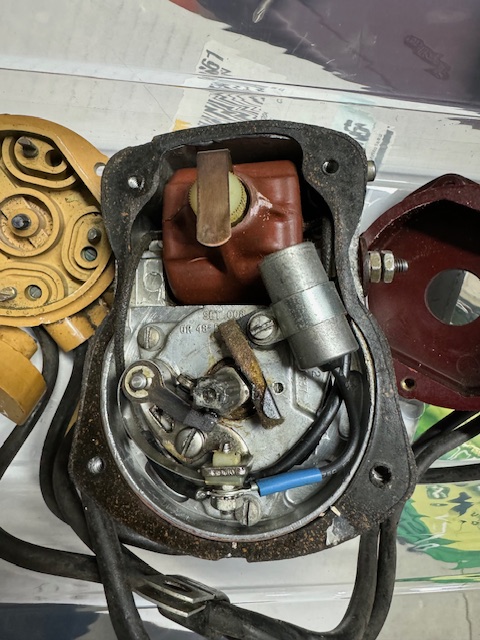

So I finally got the distributor out. Should this points throw a spark if I spin the shaft? Is this a valid test? If not how can I test which part has failed?
Any any help for the next steps would be appreciated.

The spark should jump from the copper strip to ground (casing) - be careful it's strong if working properly. A small spark should jump across the points.
The spark should jump from the copper strip to ground (casing) - be careful it's strong if working properly. A small spark should jump across the points. Clean the points with emery cloth and contact cleaner then set them at .008*
I must be missing something. I replaced the condenser and the coil and I’m spitting the shaft and I don’t see any sparks at all. I even tried chucking it into a drill and spinning it faster than I could by hand.
Would appreciate any ideas on how to troubleshoot this.
You have to set the points at.008" on the high lobe of the cam (use a small amount of all purpose grease on the points shaft) and make sure they're clean.
They are gapped properly (I think). I did hit them with a little 1200 sandpaper in-situ as they already looked pretty clean but I will double check that that didn't change them.
What would be me next step(s)?
Away from the coil (CCW), the points have to be grease free; where did you get the new coil and condenser and why did you replace them?
Check that all the wires from the points etc. are not grounding to the base.
Points are clean.
There was no spark at the plugs so I decided to replace the coil and condensor. Both were supposedly NOS and came in what looked like unopened packaging but I know that doesn’t mean they are functional. Is there a way to test them?
Nothing is grounded to the case except the points themselves and the one side of the coil.
What I have now.
All I can see from the pic. is the wire from coil to points is contacting the spring it should be isolated electrically.
There was a gap but it goes to a screw that does seem to ground to the spring.
I put it back the way it was but then again it wasn’t working when I got it.
