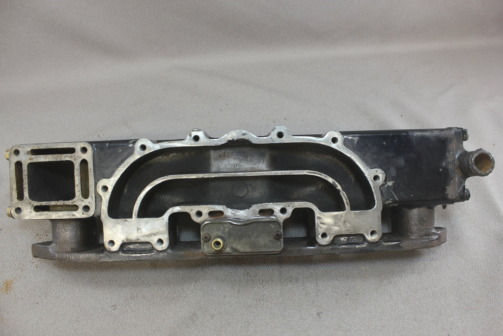

looking at manifolds and am thinking i might be better off with a new manifold
the firing order is 1-3-4-2
i think the dual carbs were only one year/1968
1 carb did cylinder 1&2 the other carb did cyl 3&4
the manifold below from 1964 to 1972 changed what cylinders were served by each barrel
1 barrel did cyl 1&4, the other barrel did cyl 2&3
the air fuel mixture would flow back and forth between 1&4, 2&3
1982-1985 omc just dump both barrels into the intake
do you think they did that so 2 cylinders werent starved of fuel if one barrel got gunked up?

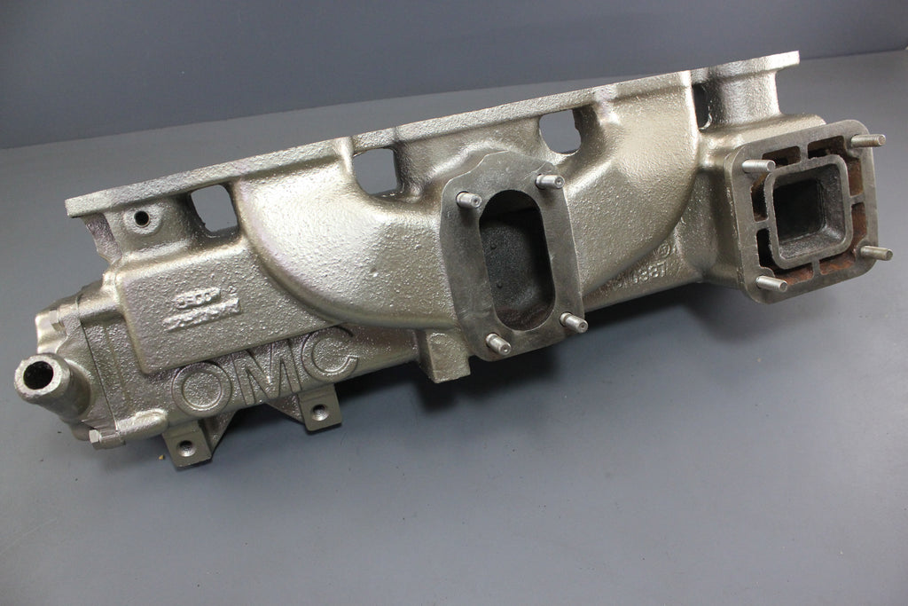

i wound up finding a manifold like the one 2 posts above but the 5th bolt/stud i had to grind the heck out of a wrench to be able to tighten the nut.

Yes you are better off getting the correct 2 bbl manifold.
