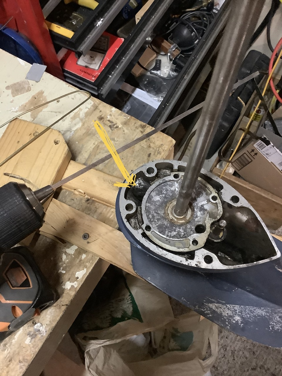

Today I dropped the gear case. When running in a trash can I noticed no water would drain out the small hole down below the cavitation plate. The entire cavity that feeds that hole was full of crap. Tried compressed air via the drain hole, no bueno.
Tried a long screwdriver, but couldn’t get it all, so I built a little roto-rooter using a cordless drill & a piece of SS flat, from an old wiper blade. That got almost all, & air the rest.

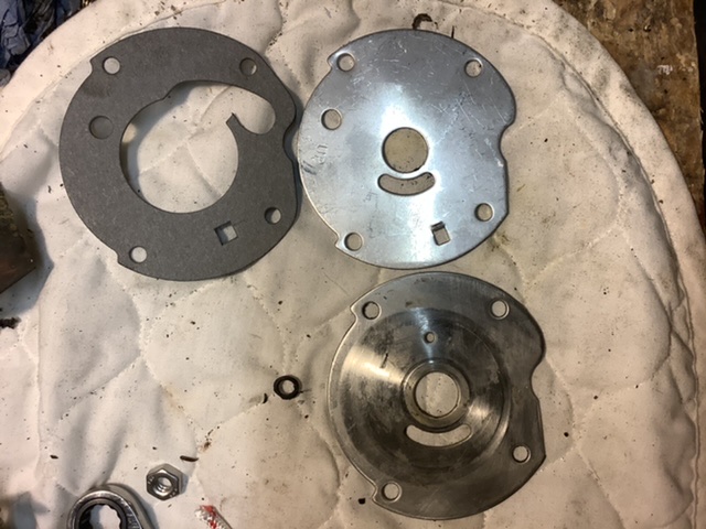

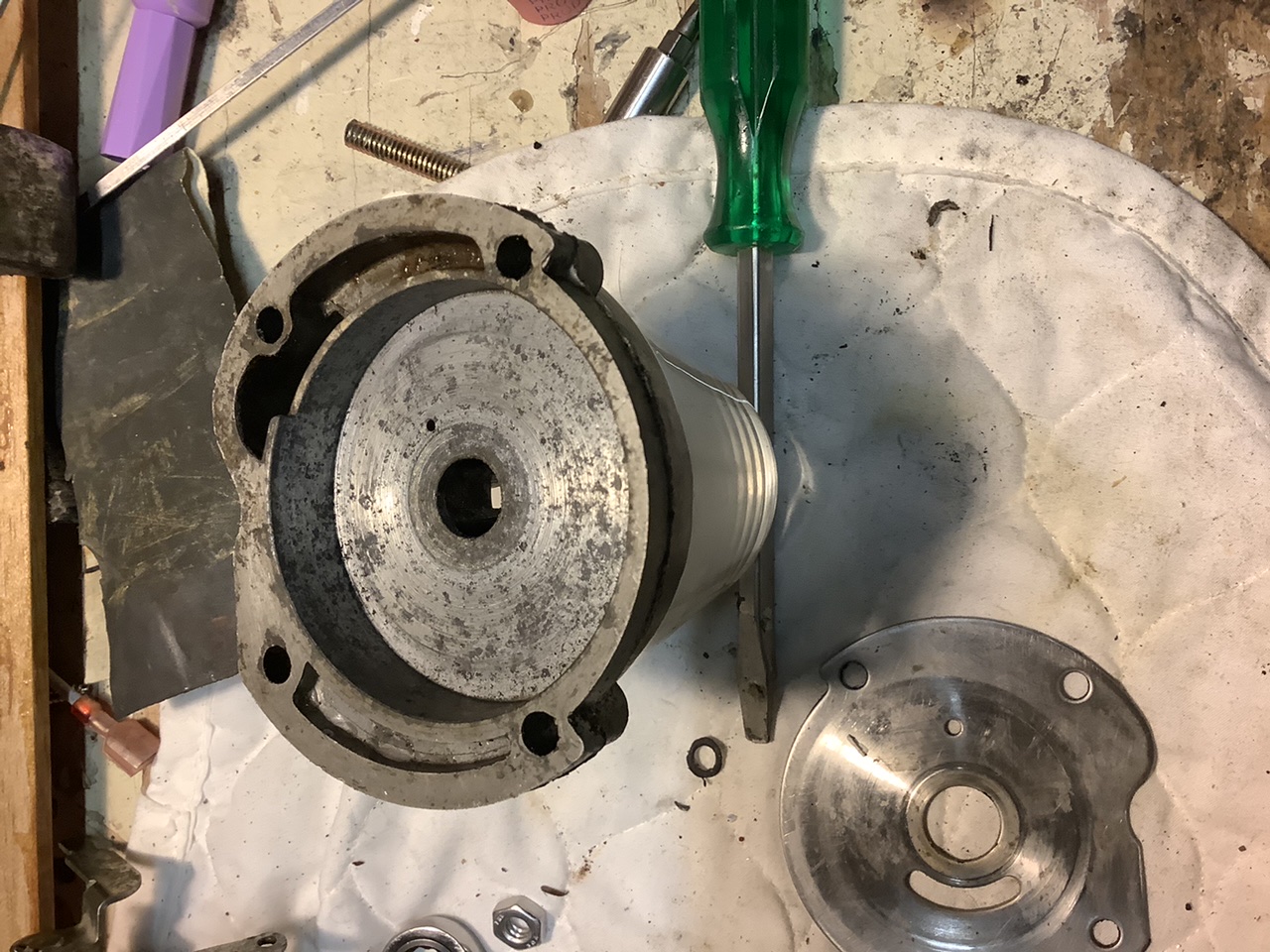

I’ve been advised the original metal impeller housing get worn & grooved, so I took that apart. Does it look OK to re-use, or should I get the new plastic housing?

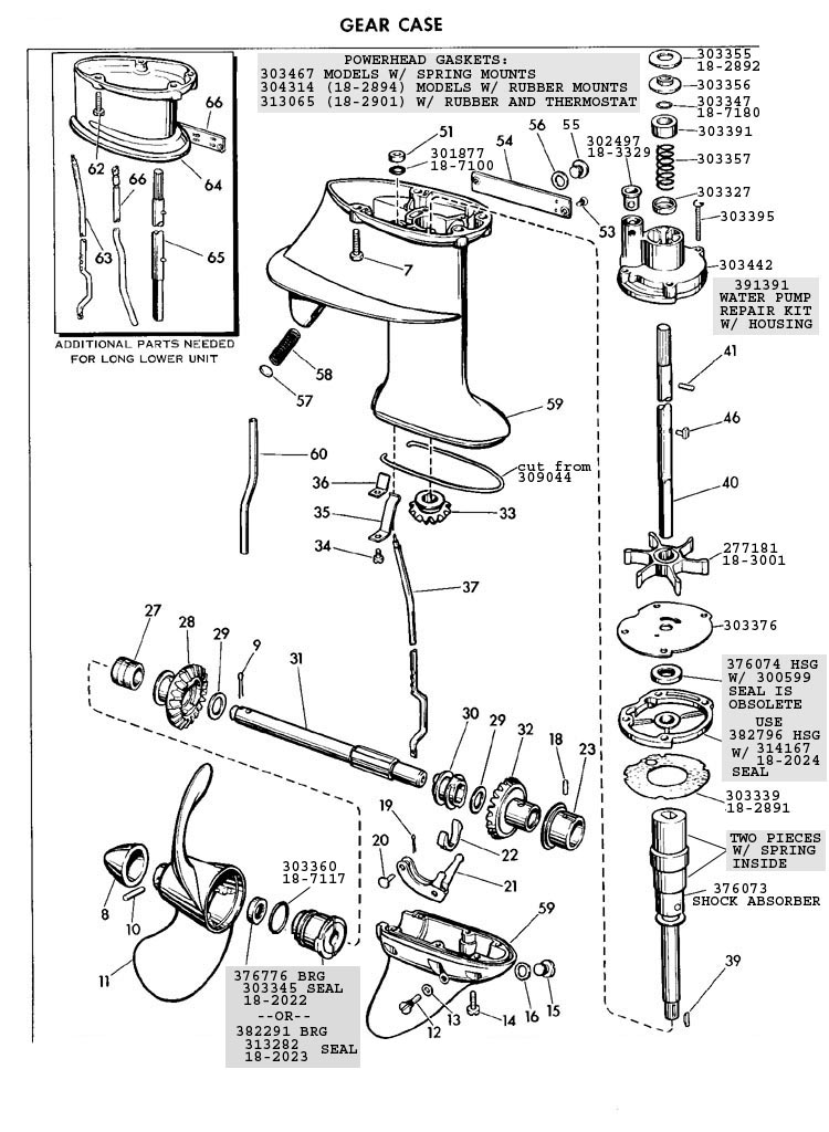

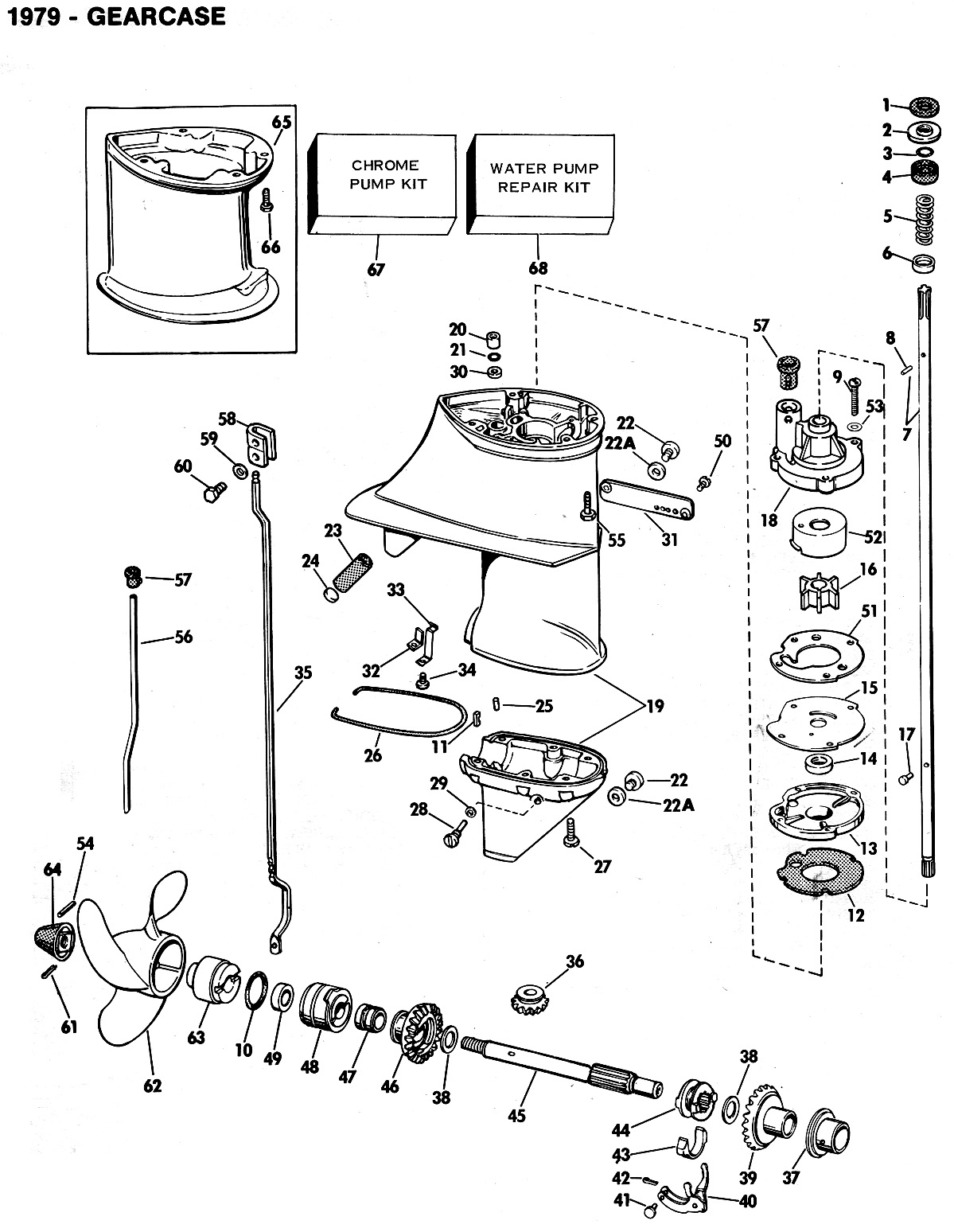

I noticed there were no gaskets above, or below the SS plate the impeller rides on. The parts diagram shows only one gasket, below the impeller base.
Watching a couple of videos, one showing the original metal housing, had no gaskets. One showing the new plastic housing, they placed a gasket on top of the SS plate.(can’t figure out how to delete the 2nd photo).
What is the proper assembly, do only the newer plastic housings use a gasket, or did that guy do it wrong?
I noticed the new SS plate is slightly different from the original. The new has a bigger hole, (near the word UP), & it’s in a different location than the original. I also see a little raised tab, which appears to match a cutout on the supplied gasket. If using the new plastic housing, does this gasket go below/above the SS plate, or below the driveshaft housing plate?

Looks like you are trying to use a mix of old and new style pumps.

Ahhh, that makes total sense now, thank you. I didn’t look at parts diagrams newer than 1976.
A local chap bought the newer kit while he was in the USA, dealer told him it would fit his motor, which it didn’t. (His is a 1955 I believe).
The kit was of no use to him, so I bought it cheap, as I knew from the part# on the original OMC box, it would fit the 70’s motors.
Looking at gasket #51, it says 2 Required for Assembly. Where does the 2nd one go, the diagram only shows one, on top of the impeller housing plate.
There was only one in the complete kit I picked up. Part #763758
That kit only needs 1 gasket !!!-----And that complete kit will fit a 1955 model 5 1/2 HP.----This stuff is so easy to me.

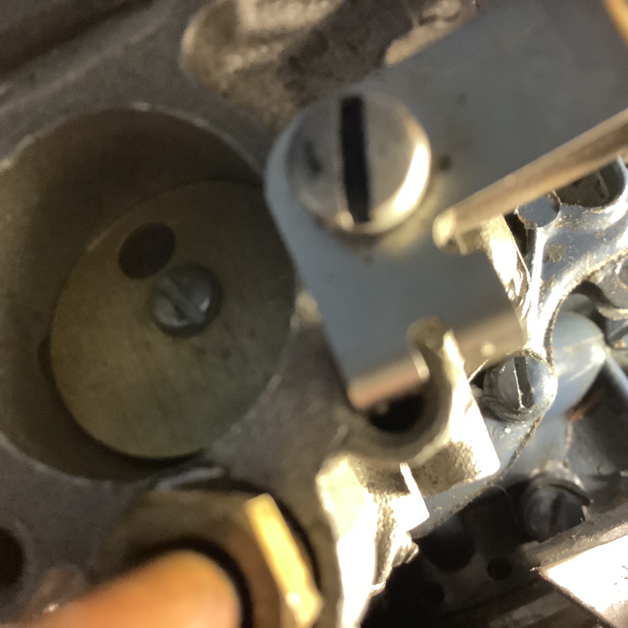

ask me if you need any parts... bought out an entire dealership that closed! One thing to test: pull out choke and quickly push it back in again at idle. if it picks up speed, the cam roller/tab arm is too far away from the throttle cam. these arent designed to run with the throttle plate completely closed at idle (no calibration holes in throttle plate in carb). once cam adjustments are made using a 5/16 wrench, it will idle down much lower without running lean. notice most (not until CD ignition last 2 years of production) dont have a stop switch hence the uncalibrated throttle plate so it shuts itself down easier.
CD ignition was availabe in 77 , 78 , 79 so that makes 3 years and not 2 as posted in #8-----Throttle plate # seems to be the same from 65 to 79 models.
Have to concur with fdrgator on this one.-----Just looked at a carburetor off a 1978 model.-----The throttle plate has 2 wee holes at the top and a cut off at the bottom.-----This would allow a calibrated amount of air in at idle !!
i stand corrected about calibration... but not about making sure throttle cam is adjusted properly. And yes racer, I was off 12 months about the CD ignition thanks for pointing that out.

I was looking at my emergency generator the other day. It doesn’t have any holes in the butterfly, but it does have a small cutout on the bottom, I think all small motors have to have some way to allow air at idle.

I just looked at a ‘71 Evinrude 6hp that I’m working on. It definitely has a hole in the throttle plate. So does the ‘74 I have.
