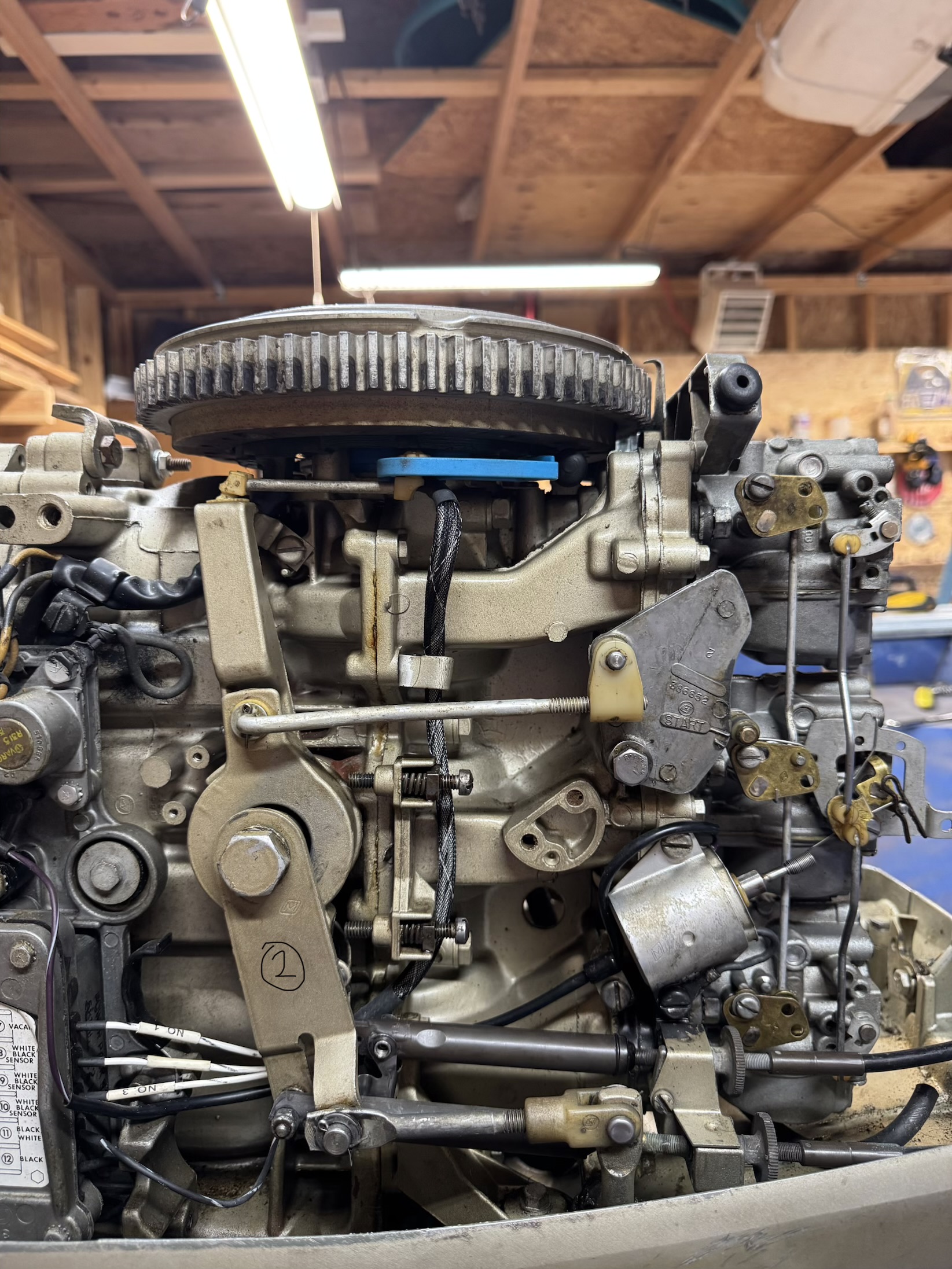

I then started following the Joe Reeves method, aiming for 13° (sticker calls for 17°), but I ended up seeing mid-20s. After manually adjusting the timing to where I would read 13°, there is absolutely no way the adjustment screw with the rubber cap can extend that far.
In the first picture, this is the idle position, and timing light lands on TDC (or would I want this to be -4° if TDC is what service manual calls for?). Second picture is with timing arm placed where light flashes at 13°. Third picture shows how far away this is from rubber cap (which is fully extended) (If the third didn’t upload, it’s about 1/2” gap)
