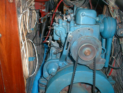

You could try the epoxy in the pitting in the elbow. Don't know how you could get a ceramic coating done. Another thought would be a machine shop that has a 'metal sprayer'. Never heard of one used for an exhaust elbow, but may be possible. Other option is to find a good welder and get it welded. Last thought is make an adapter plate so a more common elbow can be used. Never tried this, but can think how it would probably work OK on most engines I have worked on. Blue Volvo? Did the last owner get sick of the green because it reminded him of all the $ bills he was tearing up, or were they trying to disguise the fact that it was a 'green grenade'??
Alliboy, well the "blue" this was me doing de-rusting (wire brushing) and repainting things with high temp engine paint of another color...guess I got carried away with it. On the exhaust elbow I think you are on target with an adaptor of some sort. I was thinking take it to a welding shop, have the top cut off (piece that is bolded onto the engine including the water injection point) then have the shop weld a threaded piece onto the cut off part so pipe elbow say 45 degree and straighter down piece can be refitted whenever needed. However I am not sure how plumbing store parts would stand up to the exhaust heat and how threaded joints would hold up to the vibration factor. I probably will not do that unless the current one looks really bad or blows out. JB weld seems to be working for now and I can blow through the connected hose (water injection) and push air all the way through to the outside. You are right about the money pit thing concerning this engine....but I love my little Volvo cause it is straight forward to understand (pretty much) and Nigel Calders book (early edition) shows that engine in a lot of its content. Also cost of a new engine plus installation is cost prohibitive at this point. I just gotta keep my eye out and track down spares as they become available. I have been trying to watch for a used "take out" MD11C on craigs list or some place that I can afford to buy for spares. Xmission (MSB) and exhaust manifold alone are gold. So far I don't like the idea of replacing that engine with a cheap aluminum block Yanmar either. Seems like 1st overheat incident might be the end of it. This Volvo has lasted 30yrs and still runs well....anyone got a Yanmar that has done that? I don't know what other diesel will fit in that space...I've heard maybe Beta?
