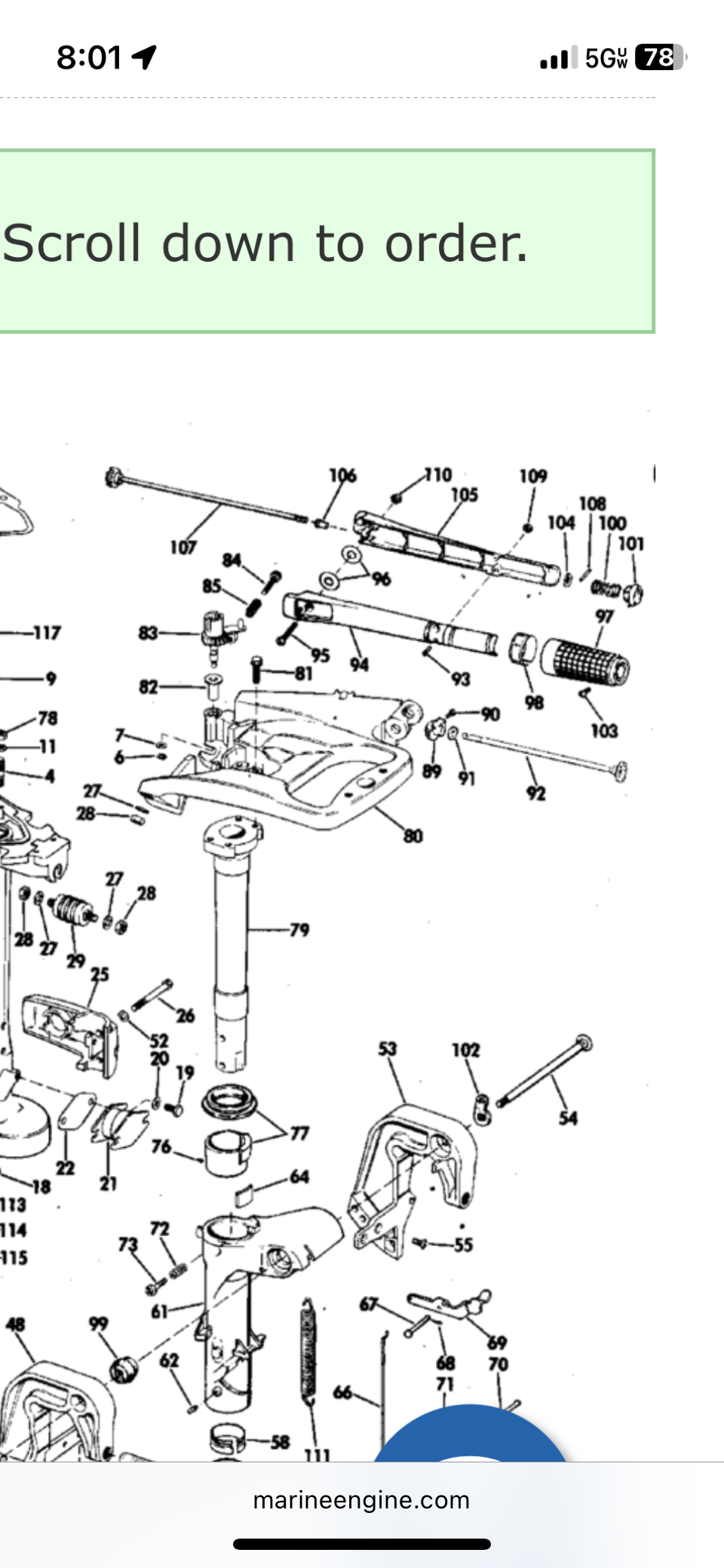

Where is the adjustment for the throttle plate? I checked the fuel pump diaphragm and didn’t see anything like a crack or hole but I will order a replacement. Adjusting the idle jet screw toward more rich doesn’t smooth it out. More recent symptom is when the ignition switch is turned off it diesels and keeps running.

WW---Stop motor.----Put throttle at slowest idle.----Post picture of the stop adjustment on that thin rod that goes to the carburetor.-----Right on the port side of the motor.----At the top of the " towershaft "
