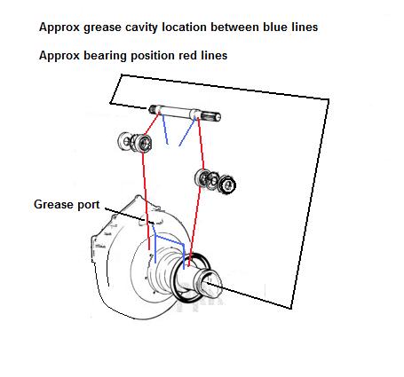

My bell housing has a capscrew on the grease port, after reading the posts, I intend to get a zerk here and grease it up, running, and listen for improvement.
Instead of doing a grease zerk directly into the flywheel cover, use an 18" grease gun extension hose (1/8" TP) with a 1/8" coupler and zerk at the upper end.
Zip tie this to the throttle cable bracket, and you won't be as likely to forget it this way!
After each oil change, and while the engine is idling, give it a few pumps of new grease. (dynamic -vs- static)
If the "Flywheel Cover" has the grease cap at the 12:00 O'clock position, I can just about assure you that you have the double bearing PDS.
The double bearing PDS is not accessible without removing the engine, or at least sliding it forward and sideways a bit.

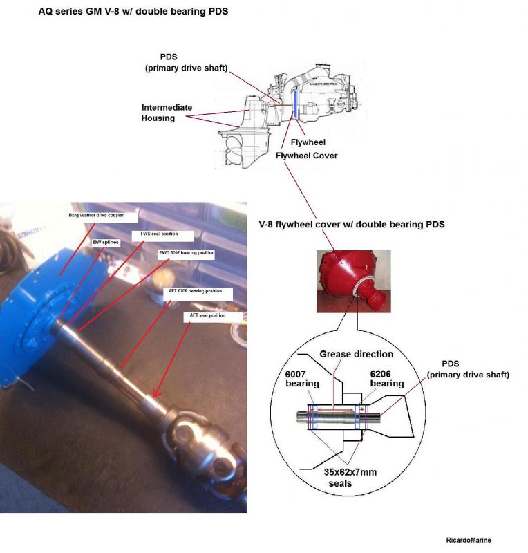

2) For bearing replacement, does the engine need to be removed on all the 280 drives,
No, and it's not necessarily related to the drive. It's very much related to the type of flywheel cover and type of PDS.
All inline 4 and 6 cylinder engines, and the later GM V-8 engines used a single bearing PDS.
The inline 4 and 6 cylinder engines will offer the grease port (open bearings)
The GM V-8 will not offer the grease port (sealed bearing)
Any of the single bearing PDSs can be removed from AFT without removing the engine!
and if not how do I tell?
For a GM V-8, if the flywheel cover offers the grease port (such as yours does), it will be equipped with the double bearing PDS.
Engine must be removed for PDS access and bearing replacement.
For most all Ford V-8s and the later GM V-8s (charcoal gray flywheel cover), you won't see the grease port.
This PDS is single bearing and can be accessed from AFT witout engine removal.

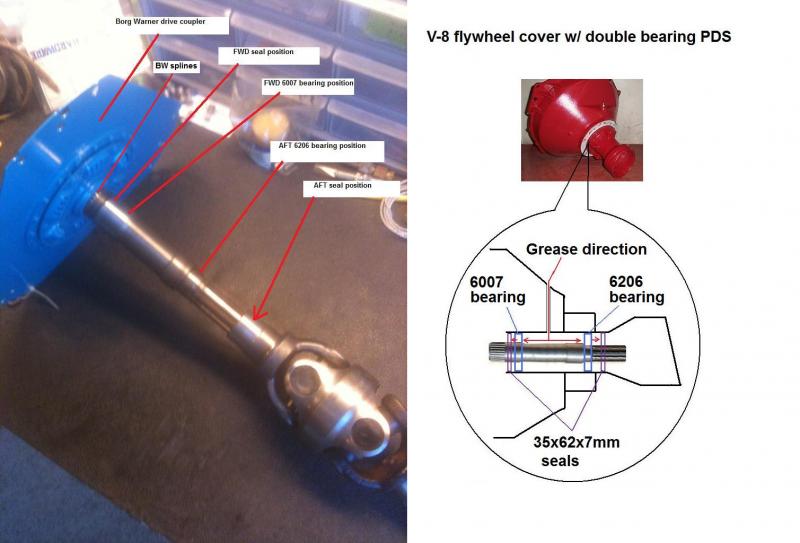

If you have the red 1pc flywheel cover, or if you have the red Borg Warner flywheel cover with the aquamatic gray Borg Warner - slash - volvo penta PDS adapter housing, the bearings and seals will be:
1..... 6206 open bearing
1..... 6007 open bearing
2..... 35x62x7mm single lip TCM or Timken seals
Larry, here are a few images for you to look at.
The one shows some damage from a PDS bearing failure. This is mild compared to what can occur.

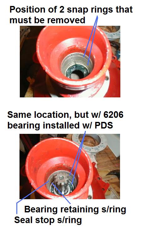

I've not found a factory made snap ring pliers that works as well as my modified long needle nose pliers. These are necessary to reach in and remove the 2 large snap rings.

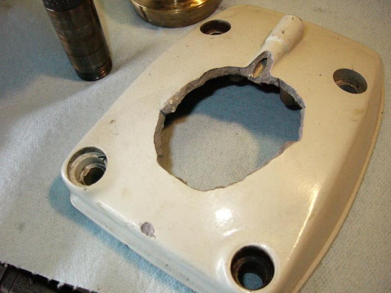

http://www.ebay.com/itm/VOLVO-PENTA...ash=item2a813cc40b:g:6nYAAOSwEK9T5UGx&vxp=mtr
That is a non-OEM part copied after the later model transmission stress proof steel split ring keepers. This replacement part is required for the earlier transmission vertical shafts because the later OEM stress proof steel keepers will not work. (shaft diameter increase)
These are being offered by DC in California who actually copied my idea for these.
I had 100 or so made years ago. I sell mine for $50 plus the shipping cost.
You just need to get the right nut for the proper end play on the verticle shaft. #839332-3-4
More importantly is the brass split ring keeper at the lower area of the transmission vertical shaft.
This OEM brass split ring keeper "checks" upward force on the vertical shaft. As the brass keeper begins to expand, up/down end play becomes dangerously excessvie. If not attended to, the expansion contiues until the keeper can no longer retain upward force.
When/if the keeper was to let go, the vertical shaft is pushed upwards and out the top cover.
(see DC's image of broken top cover below).
I have repaired several of these over the years..... all from not replacing a $60 part during a re-seal! :mad:
