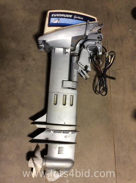

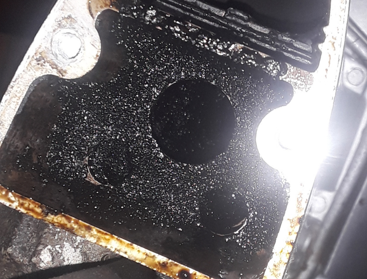

Picked up a Yachtwin today from a auction near Tim, sorry Tim�� looks to be in good shape. 125 psi dry and 140 wet per cyl compression test. Great spark. Wires are buggered up so charge and elect start are unknown yet. Decent shape for the age. Pulled carb, and looks to be a 15hp carb with a #54 jet? Large bore large venturi. Pulled lower unit off to check it out tomarrow. But noticed the 9.9 tuner pipe in midsection. But mid section on my 75 Johnson 9.9 is wide open. Yachtwin is restricted, 1 large hole and 2 small. Was this their way to restrict the later model Yachtwin? Kinda strange. But all in all not bad for $144.00
