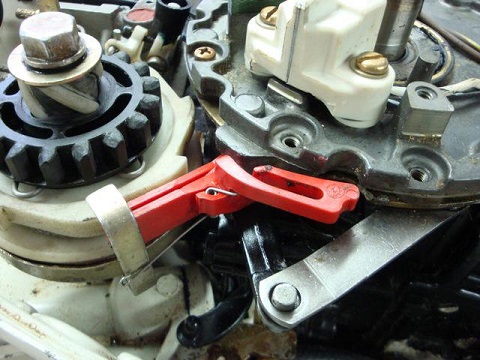

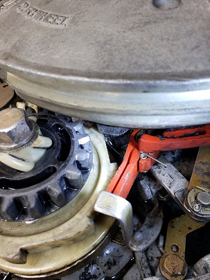

Thank you. I just rewound the recoil spring assembly...where does the little spring on the red ratchet catch attach to? I cannot seem to see the attachment point

I appreciate the effort...I am in no rush. Whatever they are called, the red lever that catches on the recoil teeth seems to interfere and when I looked closer I saw the spring that is very fine with a hook behind the recoil. I cannot see where it attaches...I must have dislodged it

I think I found it and a pic. It is the red throttle interlock dog and it looks like the spring attaches to that vertical bracket.e red throttle interlock dog

You got it. I didn't get home in time. I really don't like this safety system. It's hard on fingers when that little plastic "T" handle suddenly comes to a stop. Sometimes they barely allow enough throttle to start.....especially on a cold morning while duck hunting in late October in Northern MN.
