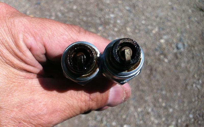

The condition of the spark plugs (black) indicates weak ignition or an extremely rich mixture.
