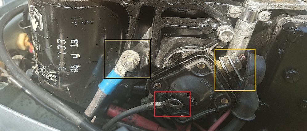

Needed to rebuild carb. To get to carb nut, had to remove starter bracket and disconnect some wiring. My dumb self didn't take a picture then. Got called away in the middle of this and didn't get back for a week. Now, can't figure out the wiriing.
The wire in the black square is the negative wire from the battery. The are two wires in the yellow area--one is positive lead from battery the other runs to the push button start on the front of the motor. So far so good. Everything makes sense.
Where does the wire in the red box go? From its length and bend it seems like a ground that could be attached to the some bolt as the ground from the battery, but bad things happen when I try that.
The wire seems to terminate on the motor case near where the tiller enters the case, but it's hard to see it so not positive about that.
Any idea where that wire goes or do I have this all messed up?
