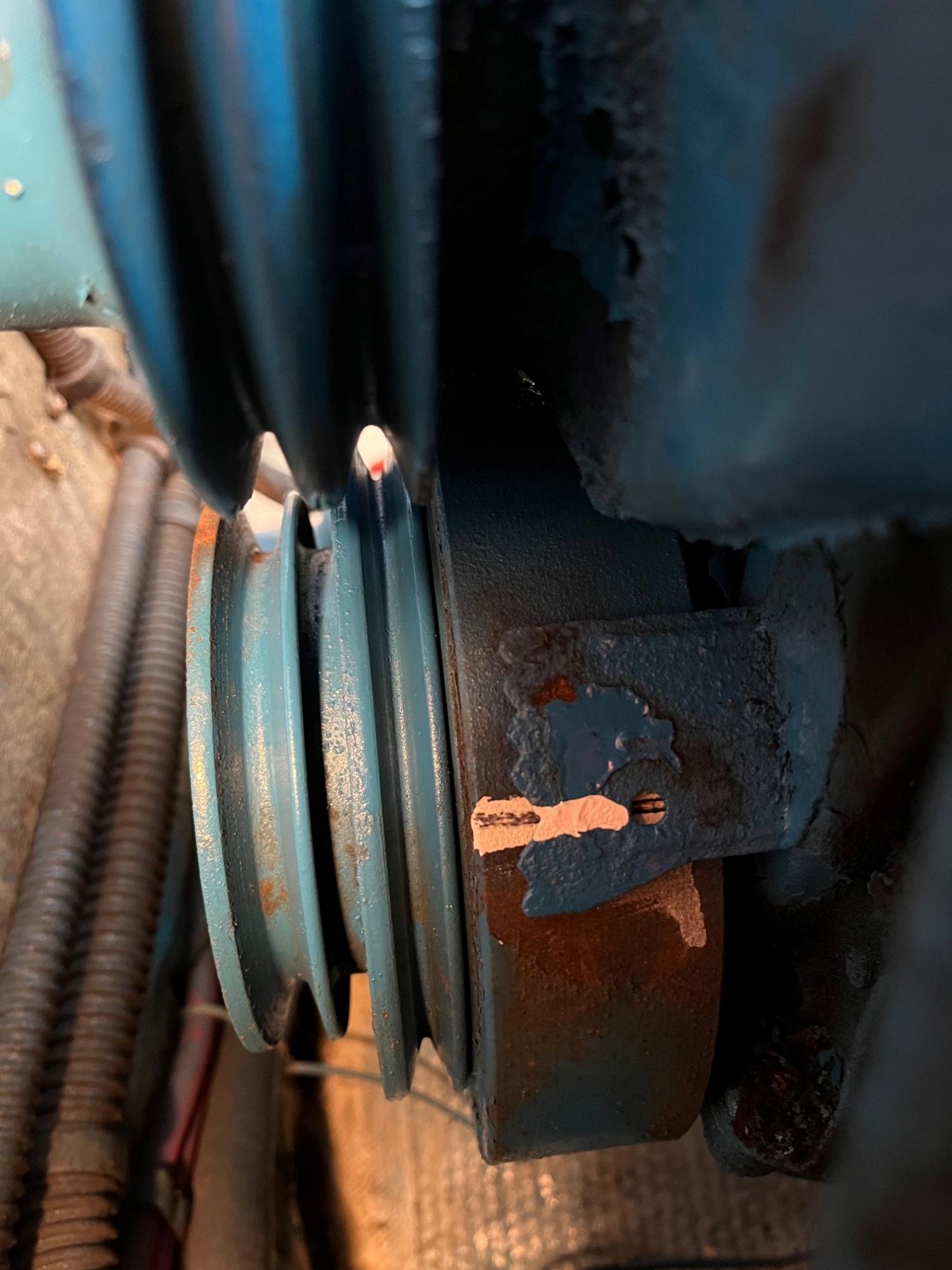

Just installed the heads after being rebuilt. Still need to install the intake manifold (waiting on original gasket to cover the EGR hole). When I set the distributor on LH motor can someone help with identifying the timing based off the marks? I believe the wider V with the hole is TDC, and the first "point" on the tab is 4deg, then 8, 12, 16. Is this right? I do not have any labeling besides the tab which was rusted and painted over.
for the most part, you have it...referencing your picture, for the LH engine, the BTDC graduations are above the hole.
The should also be marks on the flywheel you can use as a double check if you want...that said, they are likely just as corroded.
Are the graduations of each point typically 4deg?
I have a small hole in the flywheel which is exactly at 12oclock, but no reference timing marks or indicators.
the attachment should be good for all GM LH engines using the 'serrated' timing tab

pretty much the same thing...TDC does not move...big difference is the BEFORE and AFTER indicators are swapped going from LH to RH engines...

Thanks for this, it definitely saved my bacon as my timing tabs are both corroded beyond recognition. I found the part number (30173: Pointer, Timing (L.H. Rotation)) in case anyone is able to find a replacement. I searched all over the net but couldn't find anything, so I'm leaving them as-is. At least now I can set my timing with an idea what the numbers are.
you can find steel replacements for under $10 at the 'mail order racing suppliers'...I'd suspect the Crusader part is NLA...
A good parts guy at a GM dealership should be able to get them as well...
