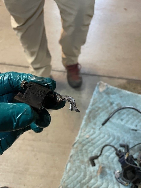

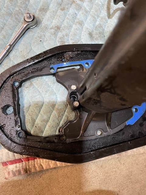

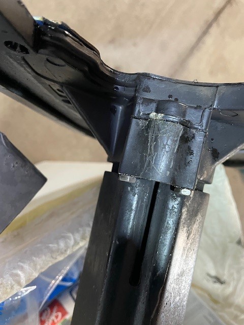

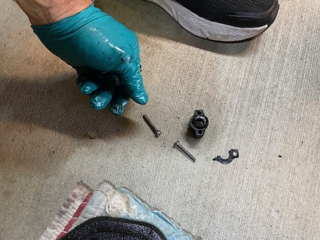

I've replaced my water pump twice and engine is still overheating. I get tons of smoke/steam out of the pee hole and when I shut down the engine it puffs out a huge cloud of steam/smoke. See photo. I suspect the exhaust plate gasket is damaged right where the copper tube slips into it's home, the sleeve at the base of the exhaust plate. I do get a little water out the pee hole when I start the engine and run at low RPM's. But if i run at a decent speed, it turns to a spray of fine mist, probably steam.
I do not have any leakage from the power head. It is dry and solid and looks like new.
To test the water flow through the powerhead i connected a garden hose to the copper tube with clear tube and hose clamps. I turned the water on low flow and immediately I get tons of water coming back at me down through the cavity in the mid section where the drive shaft is located. I also get a little water instantly coming directly down through the exhaust tube. About 80% of the water comes down the main cavity, 10-15% through the exhaust pipe and 5% out the pee hole. See pictures. Eventually a stream of water starts to come out of the pee hole. However most of the water is coming back at me down through the cavity in the mid section of the outboard and exhaust tube. Seems like the water is leaking back from the exhaust plate directly into the exhaust tube and the drive shaft cavity. Which would mean the gasket on the exhaust plate is bad?

I pulled the powerhead Sunday. The fitting that the copper cooling water pipe fit into was loose and the gasket was 70% missing. Screws were loose. I fixed all that, used some good gasket sealant on the new gasket and Loctite on the screws. Working good now. Too bad it took 6 hours and I had to buy a third new water pump and exhaust plate gaskets and it turned out to be two cheap loose screws on a poorly designed fitting as the root cause. Oh well, se la vie!
