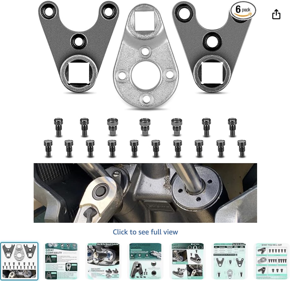

Did your "special tool" (pin spanner) not fit?
I've had to make stuff like that before when I couldn't find the right tool.
But if the one you bought fits, you might still be able to use it for tightening the bushing when going back together.
Some of that stuff from Harbor Freight (China) is just not heavy duty enough for breaking loose something that's been on there for 30 years.
You might even need to to give it a tap or two with pin punch and hammer to re-tighten it. But be gentle if you do!
I got this took kit from Amazon. The end cap hole is 4mm, The MT0004 don't fit when pins screwed in, I try to align the wrench first with two pin and screw the third pin in, kind of get in but don't fit well, cannot go down all the way. I think I need the MT0006 wrench, the one in the middle of picture, but that one is closed, I cannot get into piston. I just used a puncher and hammer to get end cap loose, it is not too bad.
Ordered an end cap from Amazon. Amazon has good return policy if it don't fit.

Well, you could open that closed wrench by sawing out the closed end if you needed to.
I hope your Amazon cap fits ok. It's amazing that you found one there. Let us know how it works out.
I cannot. I need get top end cap off to pull piston out of housing, then I can access the lock nut on bottom side.
I think bigger boat normally has one tilt piston, two trim piston. My. Bf45 only has tilt piston, but it use same end cap of bigger boat’s trim end cap. And you can access trim end cap from top, that is why that MT00006 from tool kit is closed with 4 pin. But I cannot my BF45 tilt end cap from top.
