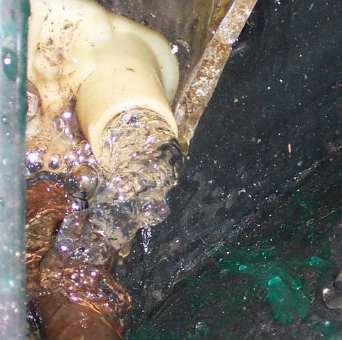

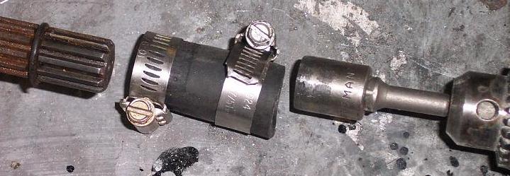

The second photo shows what to expect when running the LU on a drill. The other shows how to connect the driveshaft to the drill.

fastjeff, I was wondering how I could rig up a test...thanks. I ordered a new pump base while I had it off as that is the only thing I didnt replace... will try this when I get it on. I know the driveshafts can not be interchanged, I think the lower unit is not the one off the 40hp...maybe an earlier year or later. Its 2" longer than my old one as you can see in pics. My old one came with boat from Tracker and is a 1998 40hp 2 stroke, I bought this one as an upgrade and serial # comes up 1997.

OK, found another pump kit and installed it making sure pump outlet and tube went together correctly. Tested in a barrel of water as per Fastjeff and it seemed to pump a good volume... Took boat out yesterday and ran it all day, even let it idle once for 15 min after running it WOT. Buzzer never came on and water out pee hole was barely warm. Thanks for the help guys. BT
