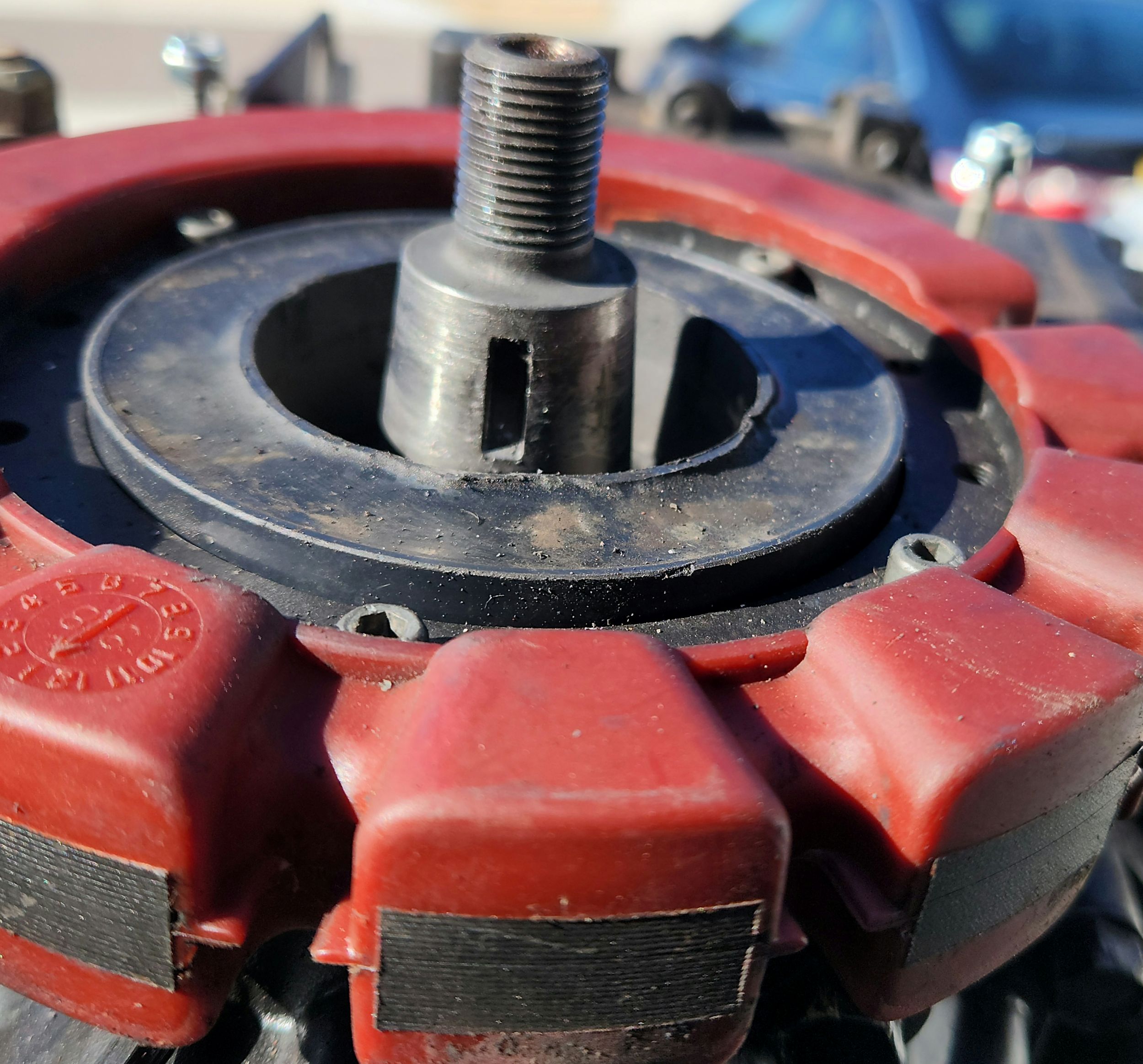

Today's lesson or flywheel 101.-----The key Loates the flywheel for proper timing.-----The flywheel is driven by the locking tapers. ----You now need to use lapping compound to restore the taper fitting.....Failure to do so will leave you stranded again !!!
