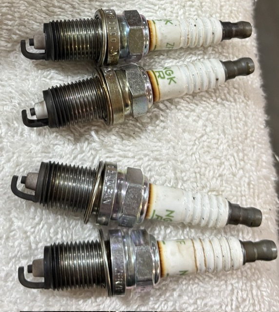

These are my spark plugs I removed yesterday, likely 8+ years old, I think they look pretty good.
They are original spec NGK ZFR 7F-11, is there any upgrade available for say iridium?

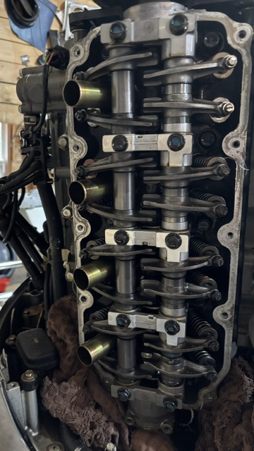

For posterity, this it it with the valve cover off for a valve check. It’s very clean there too.

No expert on plug wear but those electrodes and ground straps look close to new IMO.
Not a spec of sludge in the upper end. Good job with the oil selection and maintenance!
Hopefully this isn't the first look at valves?? I'm interested in how long it's been since the lash was measured and what it is now.
I did find references for iridium replacement plugs but hesitate to post them because, it's curious to me that the NGK number only readily comes up on Amazon and NOT on NGK so more research would be needed to convince me that the info is valid or even trustworthy. I've been burned by Amazon "aquired" spark plugs before.
There's a reference as well for a Denso irididium replacement but caution should also be used there too. Many have ruined their engines by using incompatible plugs.
Besides, your results with the nickle alloy plugs seem to have gotten better wear than I've seen on some iridium sparked engines. So, why change?
Just me "kibitzing" withchya.
I’ll use the existing spec plugs, I’ll try the dealer today.

At only 1,000 hours it might not need a valve adjustment.
Honda makes their "hard stuff" HARD. But, on the other hand, valve seats are on the soft side and you would never want those valves getting too tight. So, for your plan to check them, I say BRAVO!

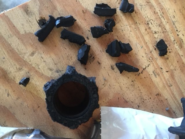

Don't fall for the "It worked fine last Fall, so I'll leave it" with a 5 year old impeller. They develop 'set' in the vanes and that weaken the water flow because the rubber doesn't return to straight after being forced to sit with them pressed to the side. Low hours/year doesn't necessarily mean teh impeller will still be good after 5 years and the rubber can become brittle. LIke the one that was in my boat.........

I’ve not had one chunk like that, that’s a mess in the cooling system. If it ain’t broke don’t fix it is not a good idea with impellers.
None of those pieces made it to the rest of the cooling system, they just fell into the area next to the slots where the fresh water enters when the idiot ran it.
Just to update my post regarding valve adjustment, they were all tight to spec. I only adjusted them this week, haven’t started it yet this year, slow getting the boat in the water this year. Am now motivated, it was 36.5C/98F here yesterday in Mahone Bay, NS.
