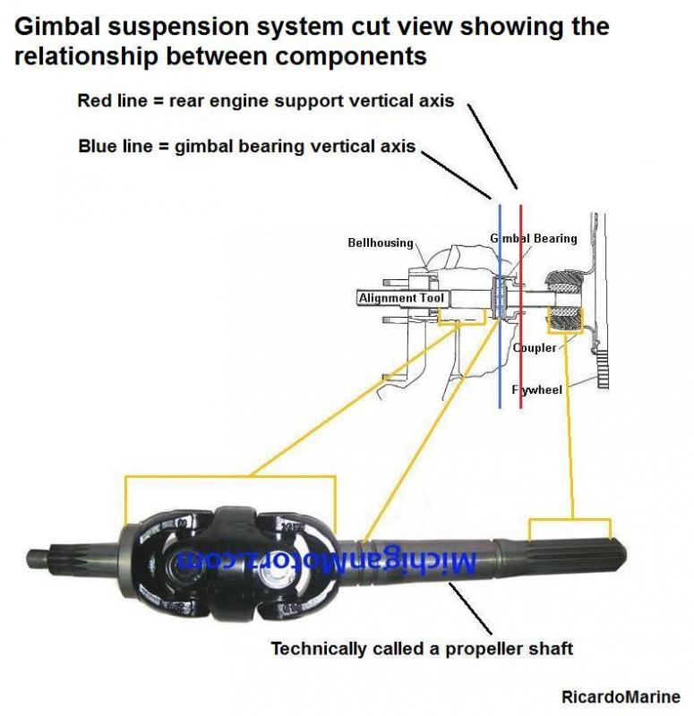

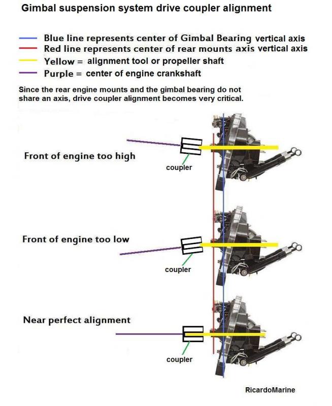

NOTE:
My first image is as though you are viewing these components from the Port side.
My second image is as though you are viewing these components from the Stdb side.
