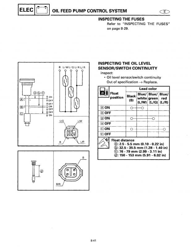

You can test the engine's oil tank sensor with an ohm meter if you have one. Here's the reference page from the shop manual:
That's about it. There's no "trim gauge" interface on that motor.
If it works with the emergency toggle switch but not on it's own it's usually just the sensor switch on the tank.

If the starboard motor works like it should, try swapping the oil level sensors between the motors... Did you run through the tests with the multimeter?
