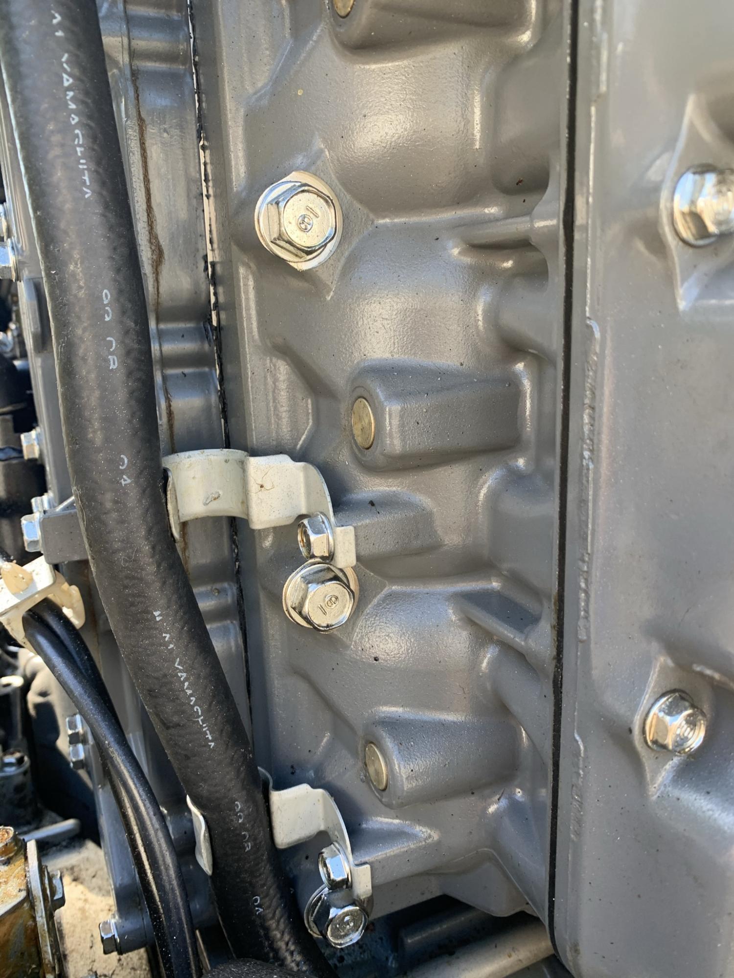

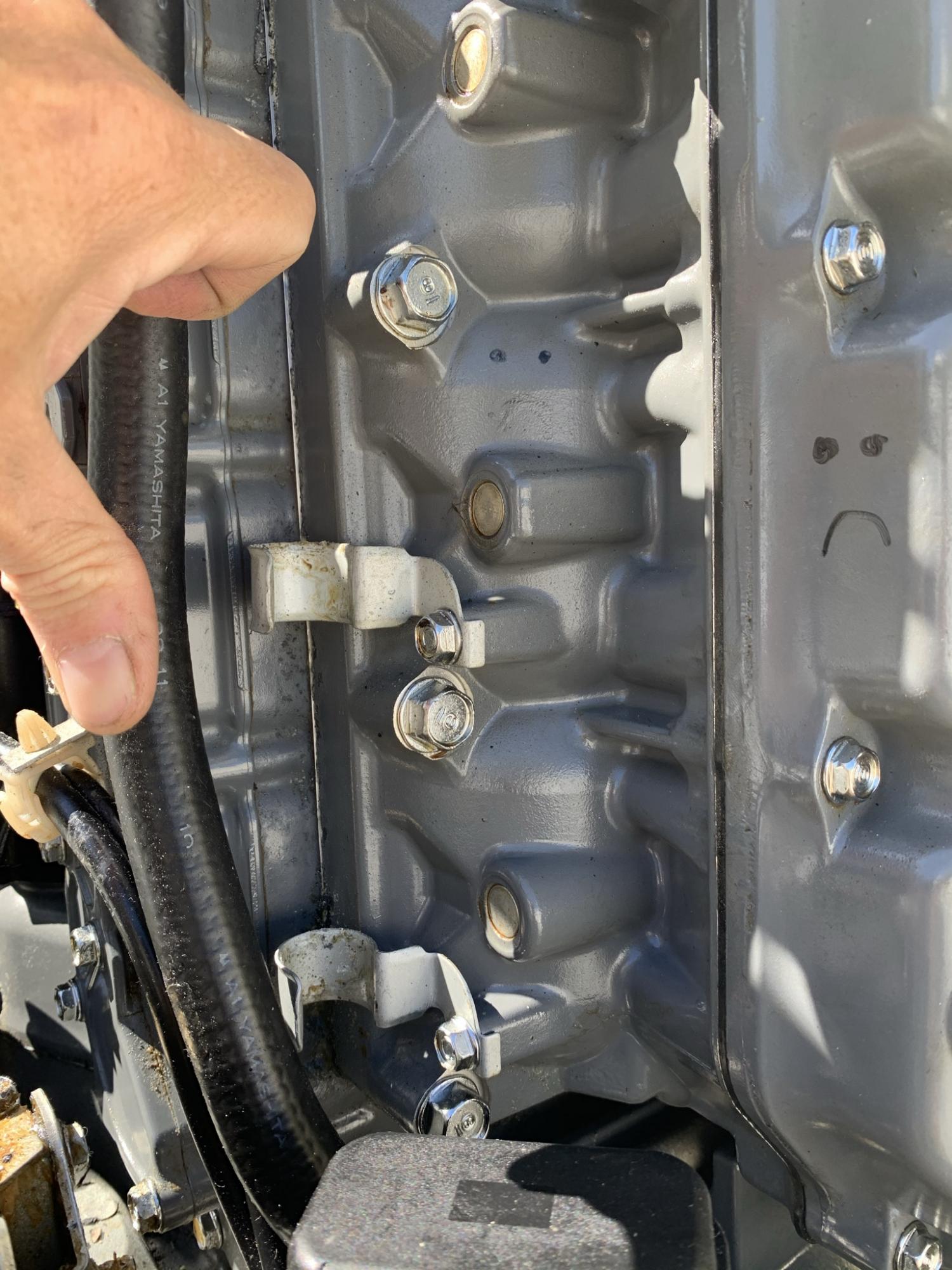

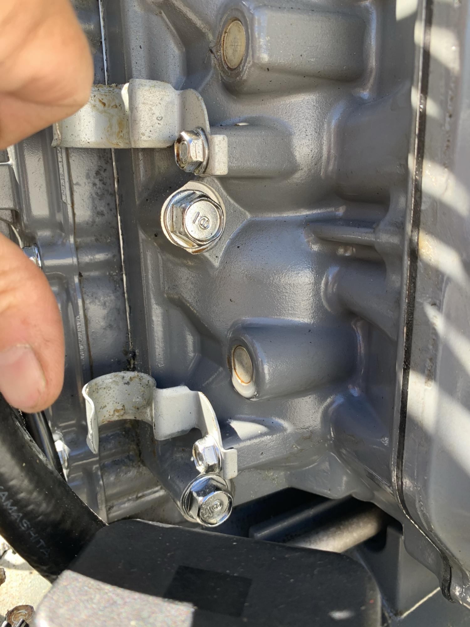

The one with my thumb is the bad engine.
View attachment 25914View attachment 25913
The "Bad" engine is not as bad as the running engine.... Life is short for these.... When the gasket starts to move it is time to shop for new power.
I would leak down the engine that will not run.... Just because you have some compression doesn't mean you have vacuum. Pull all the plugs when doing the leak down.

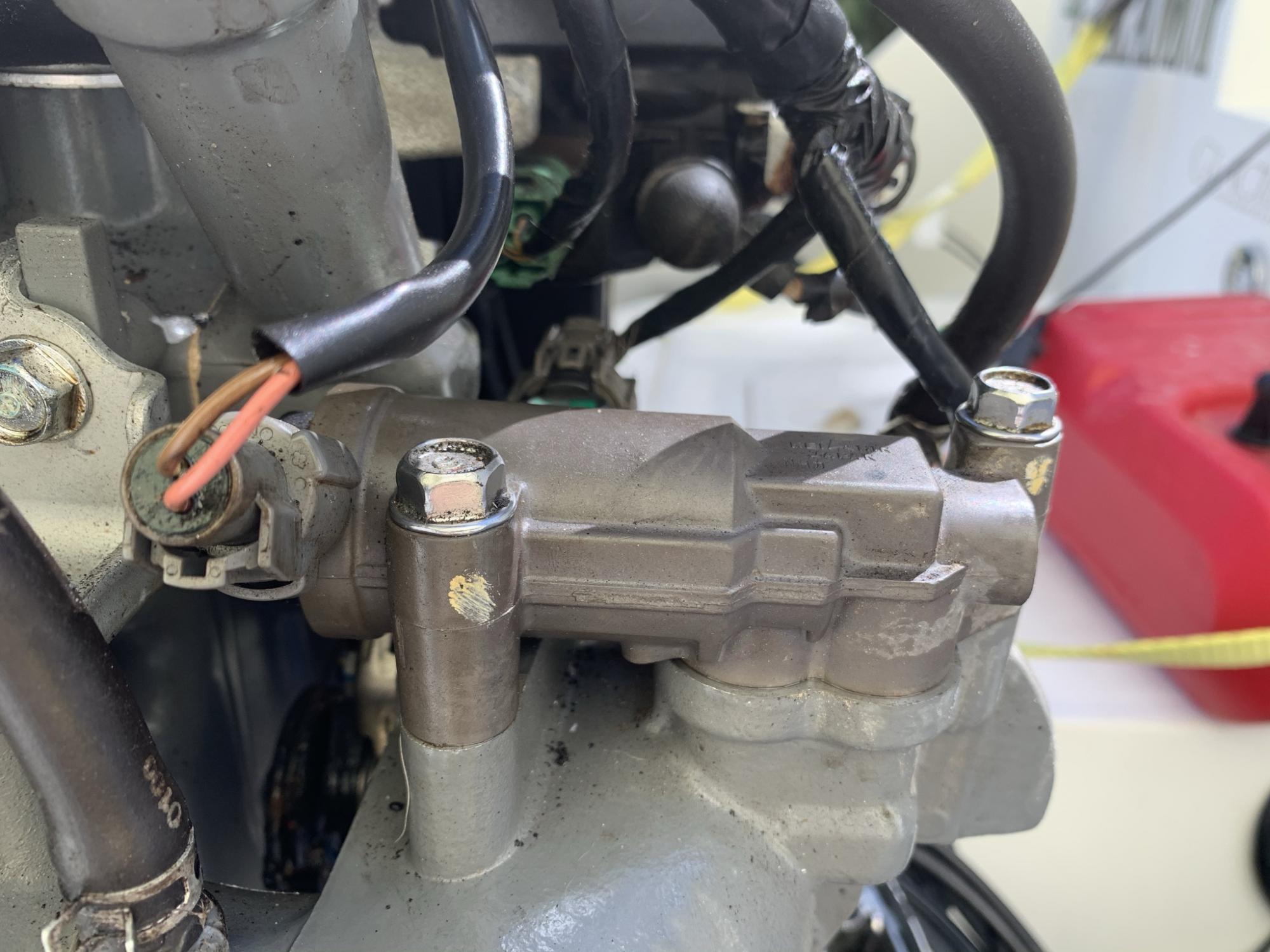

today I cleaned the IAC valve on the intake manifold and just below the yellow oil fill cap. There is a small wire strainer that was clogged on both engines. Very easy to remove and clean. Two bolts and unfasten the wire connector. Clean with MAF cleaner and blow it out with compressed air. pics below. Cleaning this will be part of annual maintenance
The air idle controller is a common issue, they do need cleaning and may even get stuck, easy to swap between your motors.

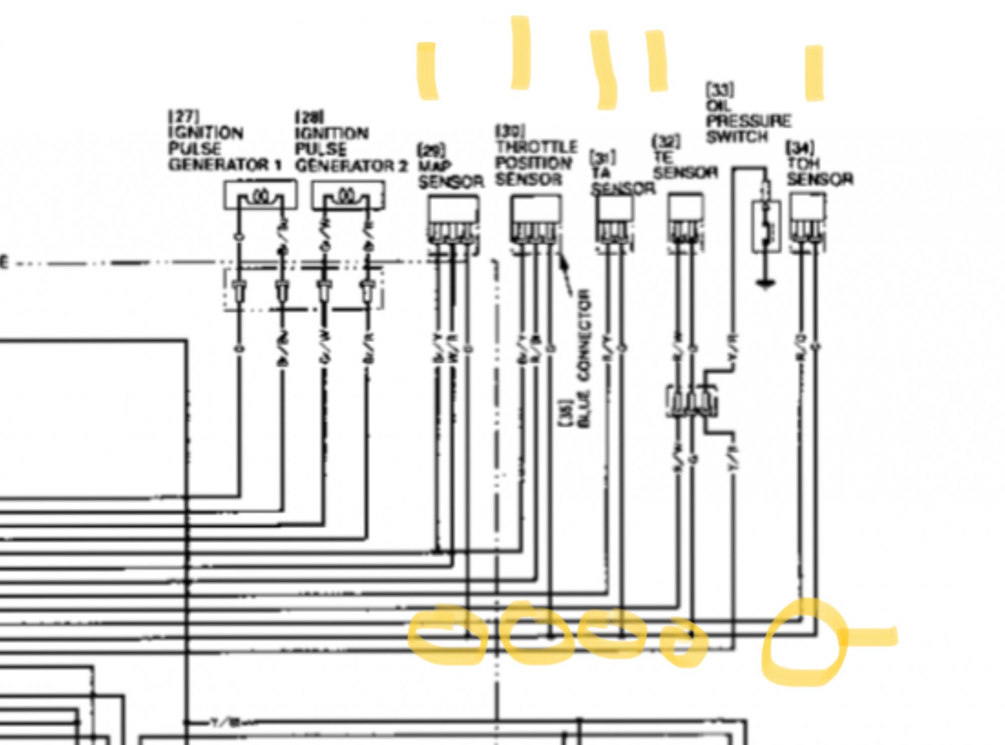

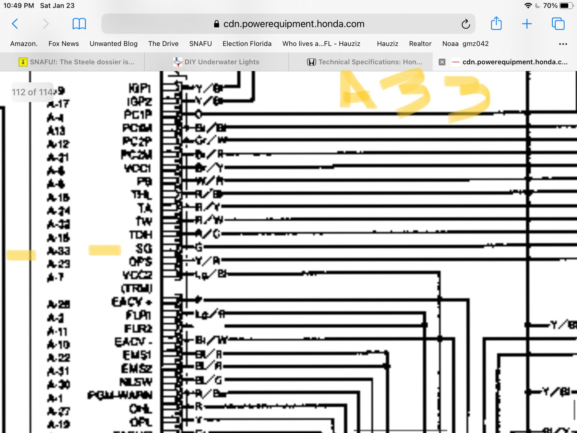

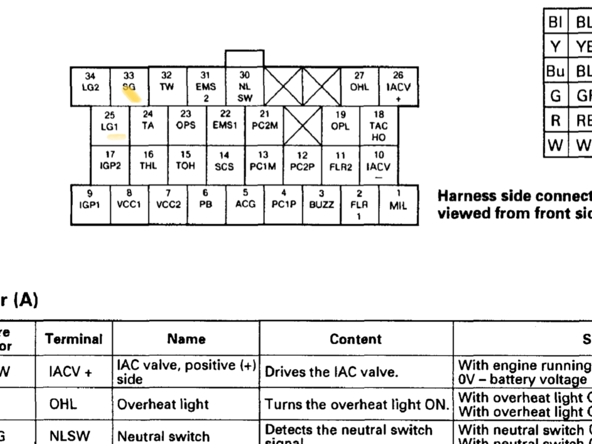

I’m going to pull the bad harness apart tomorrow. I found the wiring schematic and see that 5 sensors all share a single ground wire from the ECM.
Plug A33 SG is the ground for
MAP
throttle position
temp overheat
TA
TE

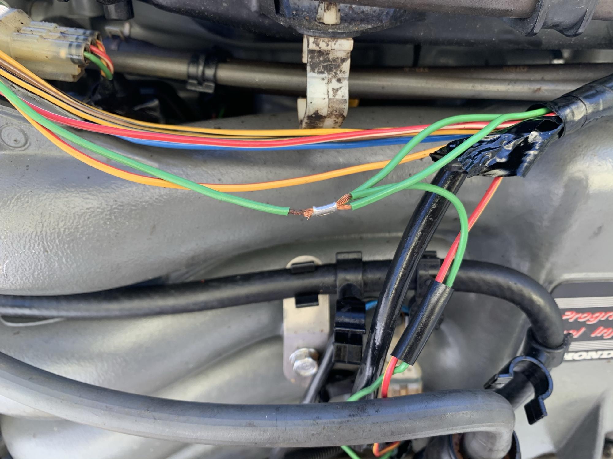

Time to pull that wire bundle apart and inspect that green wire. I need to check the other harness. I wonder if I can just run a new ground wire to those sensors and bypass the ECm or tap into it at the plug. Ground is ground right?
How do they tap off to all the sensors, wired soldered together?, if so there could be a break right at the first tap off point. You could use a meter to test between that wire on the sensor plugs. I'm figuring it's broken between the first(closest) sensor and the ECU
Inside the wire harness are several crimps wires. Basically two three or even 4 wires are spliced. I took a picture. I fixed the ground wire A33 that serves as a negative for the sensors. That made all the check engine and alarms go away.
then noticed the engine still idles rough. I began squeezing parts of the wire harness between the ECm and the intake and it would cause the engine to surge. So I unwrapped the entire harness and found another bad crimp. The wiring had turned black.
This harness came from the “bad” engine. So now my good engine idles rough. Will probably need to buy a new harness. Will see how much I can fix by splicing in new wires. Then sealing them.
this photo is the factory splice. Not mine. Their are many in there.
Not sure how much a new harness would cost, maybe it's cost effective with a new harness. Cant you get new wire and just cut off bad section and solder? Chasing bad ground is a pain but I'm glad that you're able to solve your issue.
