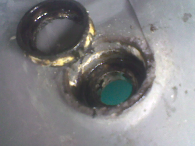

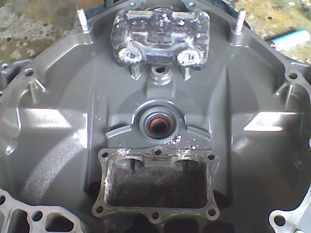

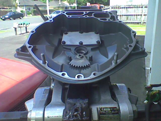

002.jpg216.jpg IF you ever have to remove the power head make sure you line the dots up on the gear shaft gears and at the same time replace the seal this mtr was used in salt water notice the salt on the seal.

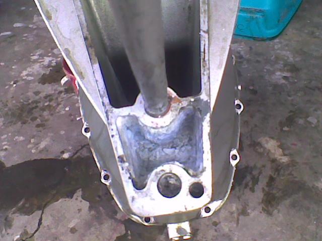

220.jpg At the same time while your gearbox is off check for salt in here if there is use Durbans Formula to clean it out and cote with epoxy to prevent it .

211.jpg The hole you see where ive the rubber mount sitting on is a blind hole the gear fits in there no oil will come out if you remove the gear shaft on the bottom side of the oil pan its got a seal replace that seal too ,its been a while now since ive done this when i stripped and rebuilt the motor.
