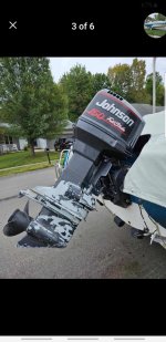

I have purchased a fine little ol' 1979 Hammond v1900 El Dorado (19' outboard) in very good condition with a trailer, pushed by a Johnson 150 Fast Strike (2000 J150PXSSC) 60° carbed V6.

This V6 150 seems to run very good, has a working VRO pump, new battery, and from what the previous owner told me; never run hard. New water pump a couple of years ago (he said he paid a mechanic $600 to rebuild the lower. I asked if he meant the gearing mechanism or just the water pump. He didn't know, at least the pump).
His wife got it from her grandpa who bought the boat and trailer new in '79. Not sure how it came to have the 2000 150 FS, but that's all I was told. It's a sharp boat, and I am trying to get a benchmark reading of the motor.
Anyway, I suspect that this motor has been gently used. The gent said about 4000 rpm is about as high as he'd revv it.
