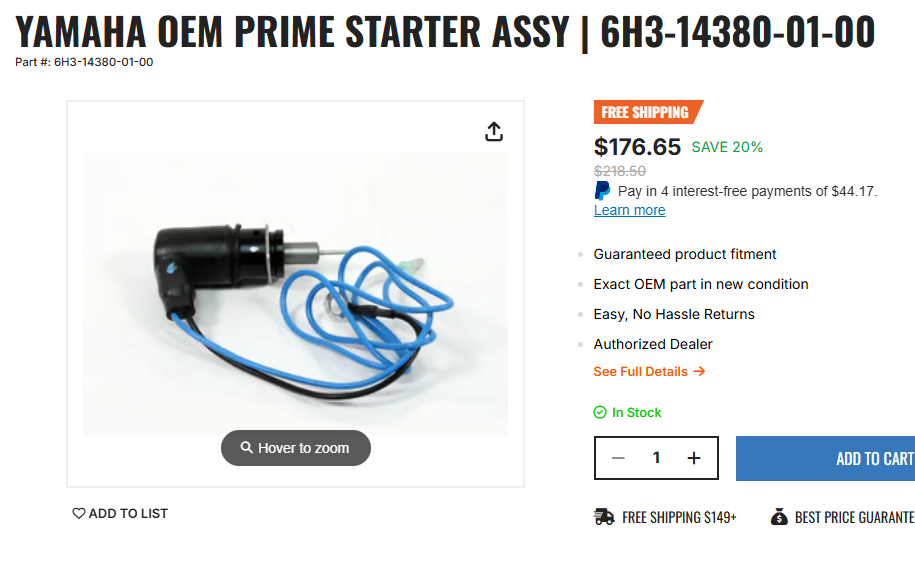

Thanks I'll check that out for future reference. I was able to get an OME one. I'm going to have to look inside one of those soon! I checked the omes and they are inspecs. Do you know what makes them fail?
Yumbo is a Japanese supplier, they have OEM parts for Yamaha, Honda, etc. They do have parts out of stock at dealers, plus cheaper prices. But you pay shipping from Japan.
I hang out mainly on the Honda forum, it seems many over there have used Yumbo.
I’m working on a friend’s 2007 2 stroke 15hp Yamaha, US$426 at Crowley but out of stock, $250 at Yumbo, but I found a new Chinese one for $10 on Amazon, free shipping. What have I got to lose? It’s worth trying?
Thanks! I found a OEM for $125.
