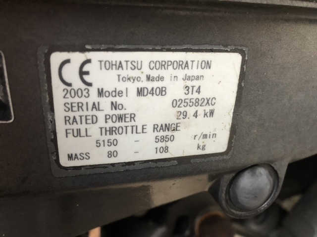

I purchased a Carolina Skiff with a nice sounding 2003 Tohatsu. It looks like an extremely low hour motor. What kind of compression results should I expect to see as acceptable? Anything else that can be shared about this motor if anybody is aware of anything.
Attached a picture of model

OK, so you have an MD40B (TLDI). That's a direct-injection 2-stroke, that requires DFI oil. What is the compression?
