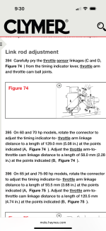

I have a Clymer manual for the above motor. The manual covers many years and is generally accurate but not always dead on for my year. Does anyone have a manual for this model? Specifically I am looking at the sync and link part of the throttle/carb adjustments. The info in my manual is not correct for my motor. It says to adjust the linkage to a length actually longer than the rod. I found one for another year model that was different so I’m hoping to find the specific one for my engine. I’m attaching the page from my manual for reference. My issue is that it runs great at idle and 1/3rd to full power but rough at “trolling” speed. Wanting to go thru the process to make sure timing and settings are all correct. Thanks!

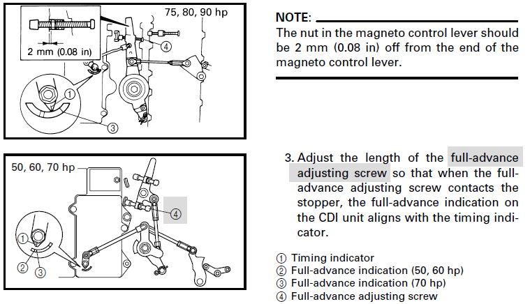

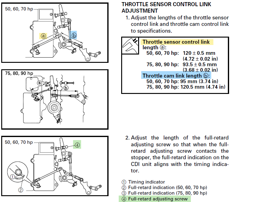

Thank you. I found that exact diagram online and the poster said it was from a 1999 manual IIRC. I was able to adjust to the lengths indicated. The length from my manual is longer than the actual rod. I have yet to check the timing. Will do that next and go thru the procedure outlined in the manual. Thank you
