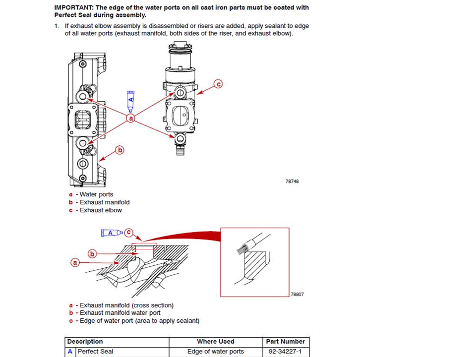

Use perfect seal or Aviation Sealer on water ports
Manual 37

It's your motor you get to decide, I just posted from manual 37

Being your engine is a 2005, your bulletin is for the older style manifolds and was created in 1999.... Your style gasket/manifold had started out as a cold manifold in 2001/02 era then went to a warm manifold around 03/late 04 I believe the years were ...Either way/type, it's still recommended to put down perfect seal (even on closed cooling systems) as still indicated in a MerCruiser manual dated 8/2009 all in the following manual sections that are available to be seen online,
