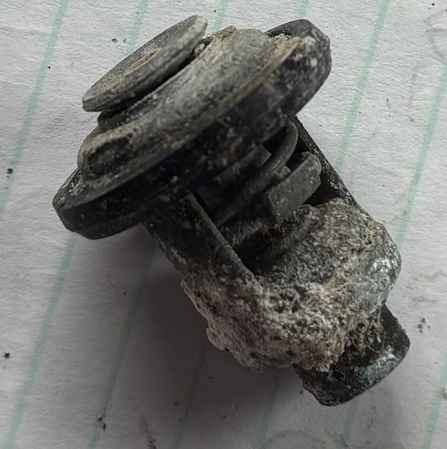

Thermostat was toast, lumps of salt crystal in there, ordered a new one.

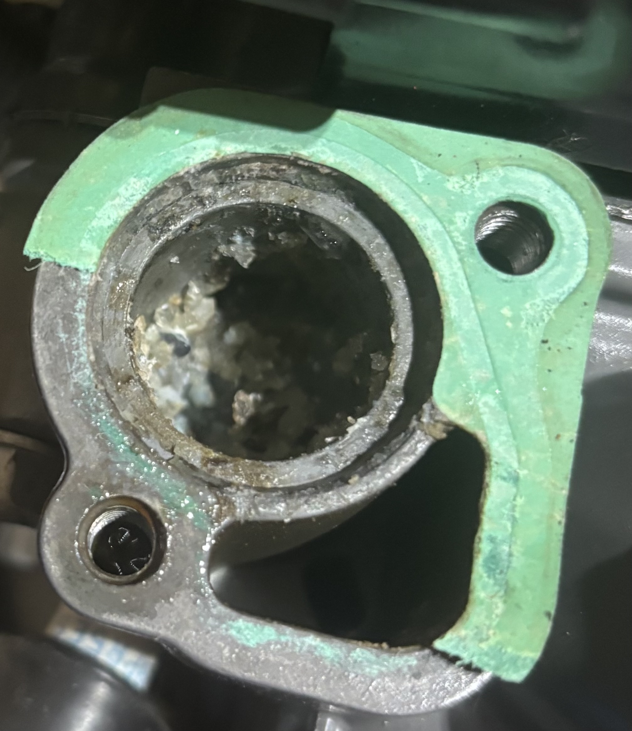

This is what I vacuumed out of the thermostat housing. The thermostat was every bit as ugly.
Hi.
I think running it in vinegar solution might be a good move on that one even though it sounds like the contamination hasn't affected the cooling all that much.
