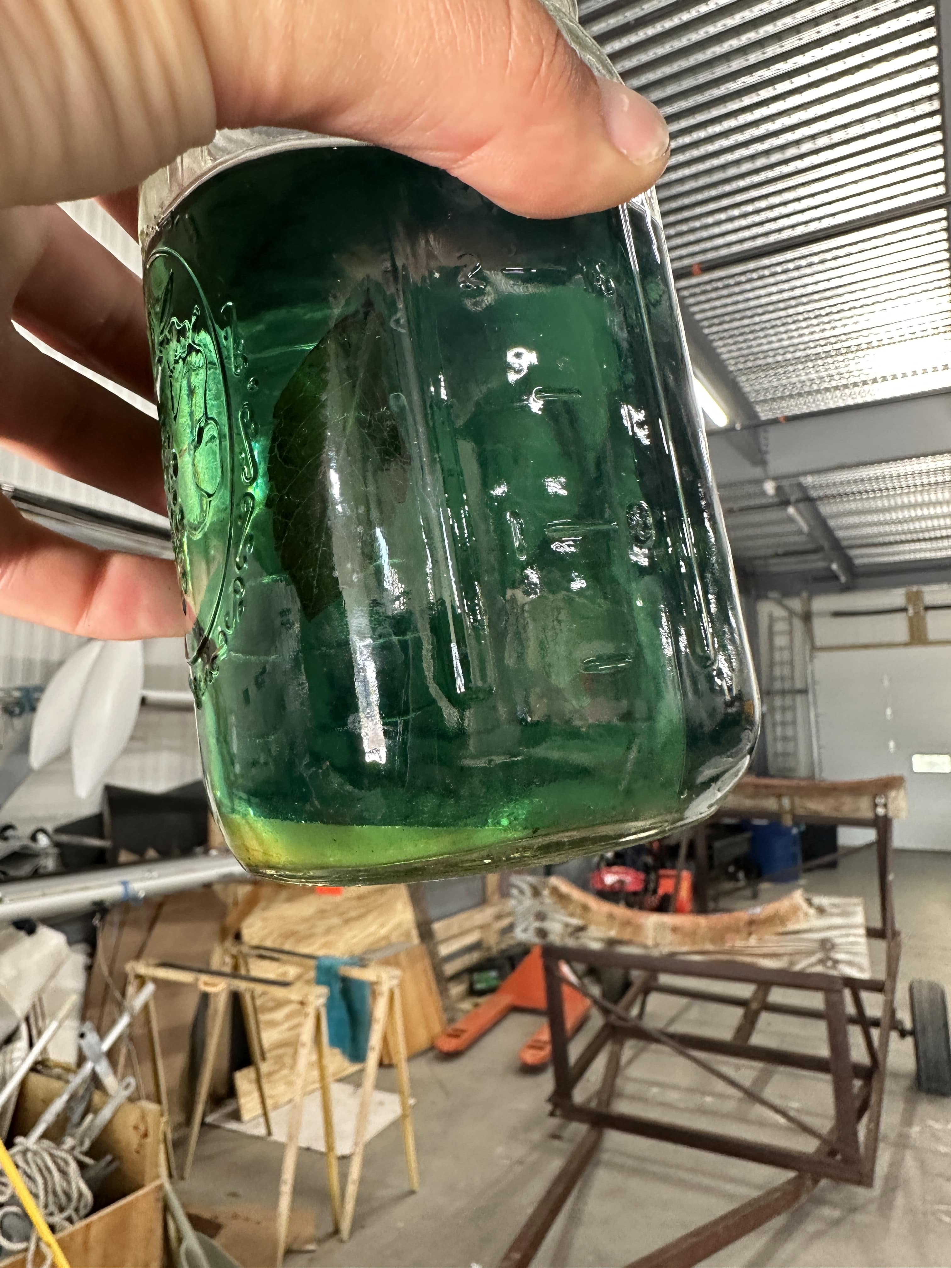

Ended up siphoning some gas out of the tank & letting it sit. What do ya know, water in the gas. I had ruled it out originally because I had just brought my old gas to be disposed & filled it with all new nonethanol the day prior. Best guess is that the worker at the hazardous waste facility washed the tank out with water & I didn't notice when I filled it back up.
Siphoned out the tank & hose am going to let the rest evaporate overnight. Will drain carb & try to work it out of the engine tomorrow, cycle some new gas through. Will update if it works for anybody who finds this thread later on

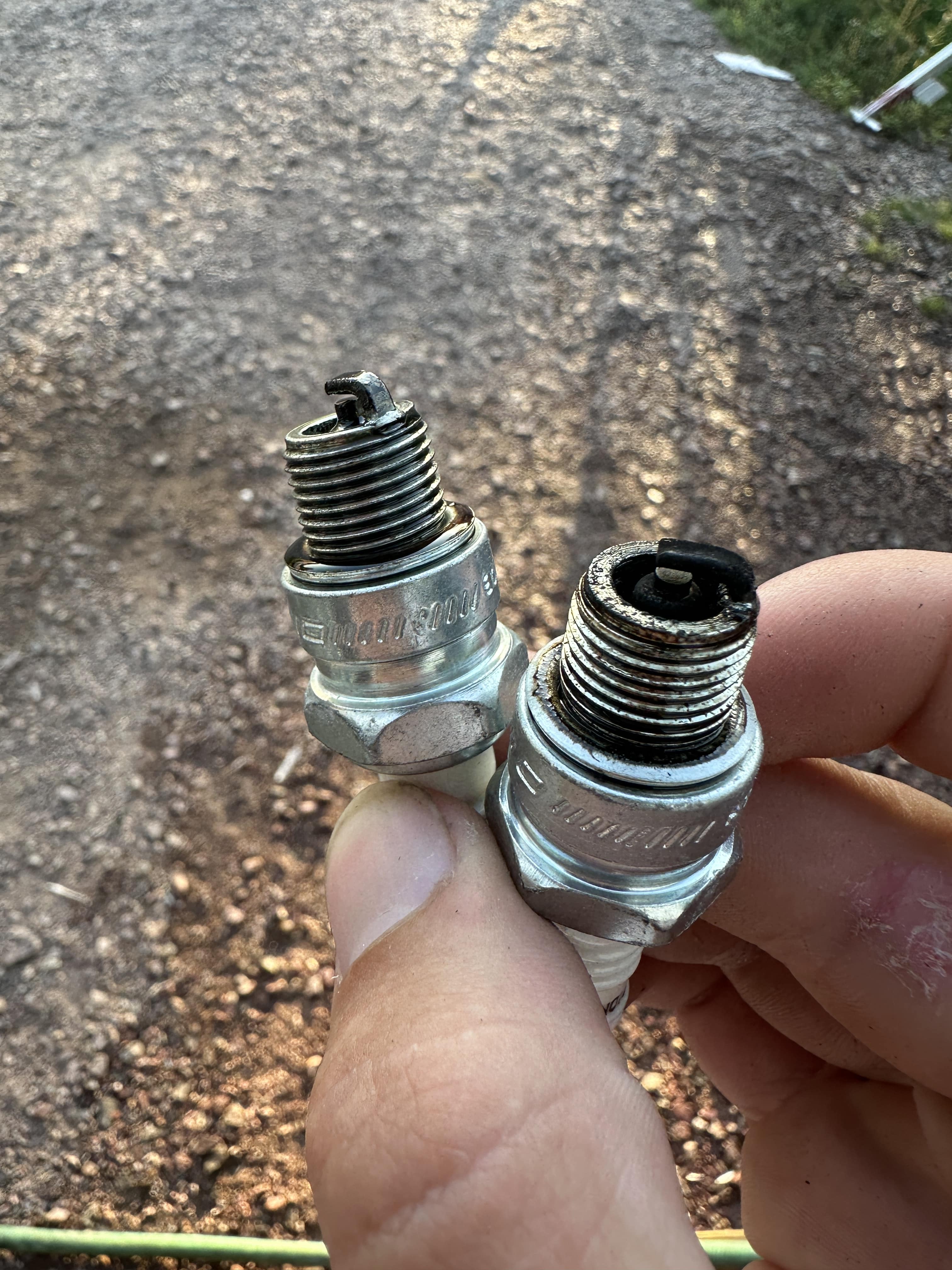

Hey all,
Did a few things
  • Dried tank and hose over a few days, disconnected bulb
  • Drained carb, cranked it a few times, let sit overnight. Did not take bowl off of carb, just removed bolt & drained into rag
  • Pulled plugs, sprayed some fogging oil, cleaned off. Photo attached of plugs prior to cleaning. One was wet, the other was not. Cranked it a few times to see if anything shot out, but nothing did. Paper towels stayed completely dry
  • Put new nonethanol, some sea foam & heet through. Have run for about 10 total minutes
It has somewhat improved, but is still running very rough. Occasionally revs up for moment as if it's about to come back to life, but then rumbles back down to as seen in the original video. I can now throttle down more & she sounds a bit healthier.
The only other change is that there's now a residue building up in the prop. Seems like just unburnt oil/gas coming through exhaust. I assume it's because I have to run it wide open throttle for her to chug along and not all the gas is getting burned
Thanks for your input so far. I'm going to keep running it in hopes that the heet cycles through enough to pick up the residual moisture. Any thoughts welcome
