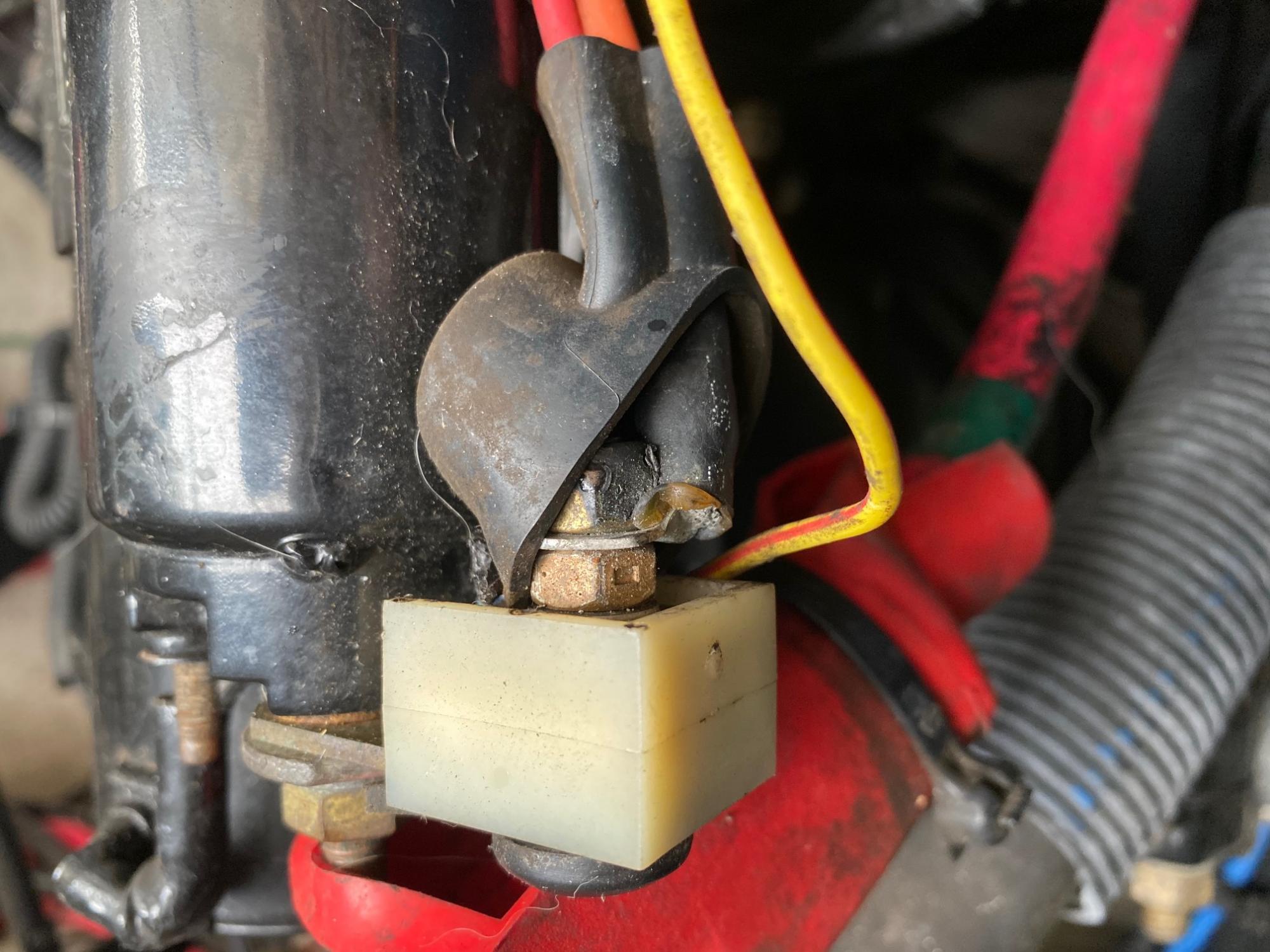

starting at the starter, power comes from the battery cable .On this post is the battery cable and a plastic squarish block that has a Red and Orange connected together The REd is main system power and the Orange is the Alt wire.Accidently shorting out the alt or its output wire will blow this 90a link.
Check to see if the Red wire is connected at the starter
<img src="http://www.marineengine.com/boat-forum/attachment.php?attachmentid=26634&stc=1" attachmentid="26634" alt="" id="vbattach_26634" class="previewthumb"><br><br><br>you mean this?  I coincidentally just bought new ones...I thought they looked corroded and bent.  this pic is from 3 weeks ago before the trouble started

Ok did figure it out and correct the issue Bt Doctur was spot on... it was the 90 amp in-line fuse
niw everything it working perfectly again, it’s even charging properly
