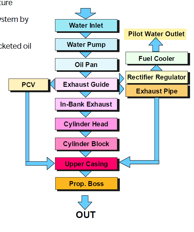

Water flows upwards from the water pump through the oil pan.
First stop is the exhaust guide. From there water goes in two directions.
1. To the rectifier/regulator, then on to the fuel cooler, then on to the tell tale.
2. To the motor itself.

Boscoe,
Your informative diagram helps to understand the flow of cooling water in the motor. Thanks for sending it.
You mention the thermostat has nothing to do with water flow out of the tell-tale and your diagram seems to show that. But I thought that with the thermostat closed, there would be no flow of coolant in the system and thus no water coming out of the tell-tale until the thermostat opens and flow starts. What am I not understanding? After my repair, there was no water out of the tell-tale and the motor overheated. After running with the port side thermostat removed, there was an immediate flow out of the tell-tale and the motor did not overheat. Then there is the starboard thermostat that has not been touched. I guess I'm not understanding how the two thermostats function and what action I should take at this time.
In some Mercury Marine motors the tell tale water comes after the thermostat. Known as a hot pisser. Yams are cold pissers. Water is generally luke warm at best.

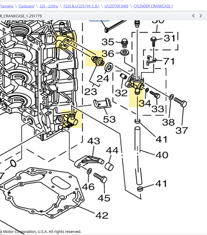

More on the path of water flow out of the thermostat.
